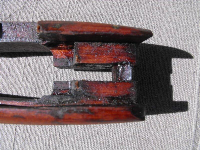

    Hi again all,
    For xa-coupe, a complete photo:
    And following a quick strip down, a shot of the rear forestock, where the recoil pads should be:
    Sigh, looks like nothing, although it's definitely an OA product:
    It all seems to be in reasonable order otherwise - a few loose threads and bumps etc.
    Thoughts on how best to proceed? Is this a scream bloody murder with the vendor scenario, or should I suck it up and get it fixed?

    my opinion is that if you paid a good shooting non matching price for it then maybe keep it and just enjoy it as it looks like a nice clean rifle. If you paid a price that reflects matching parts and so on then take it back.
    As for the lack or recoil plates, if it is nice and tight I wouldn't sweat it.

    From this thread and the lack of the copper recoil plates in Arlo's fore-end, are we to believe that some Lithgowicon rifles/fore-ends were manufactured without them. Or are they just missing?
    If they're just missing Arlo, might I suggest that you just replace them by wood patching. If you can't do it, thgere will be someone nearby who can. Just follow the photographic instructions on a sub thread here. Afterwards, you'll have a nice tight fitting fore-end too

    There was a period in Lithgowicon production when they left the plates out.
