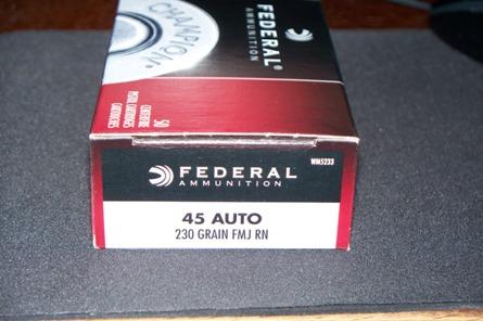

    Went to Walmart to buy some .45. This box was only $17. Now I know why, small pistol primers. There is no designation anywhere on the box that this is clean, green or special ammo in any way. It has the std lead warning label. Using my Dillon, the only way to handle this is to size & decap them singly, then prime them separately in the Lee Autoprime. Then I would run them into the Dillon at the powder charge station, and replace the shell retainer button with my finger at the bottom. Not sure I want to mess with it.

    I am in the middle of a run of .45 so I am not breaking it down. I bought these to run some "factory" ammo through a new gun, that test is done, they shot ok and the gun shoots fine. Just because I like to experiment, I went ahead and loaded them "the hard way" which did not take very long. We will see soon how they perform.

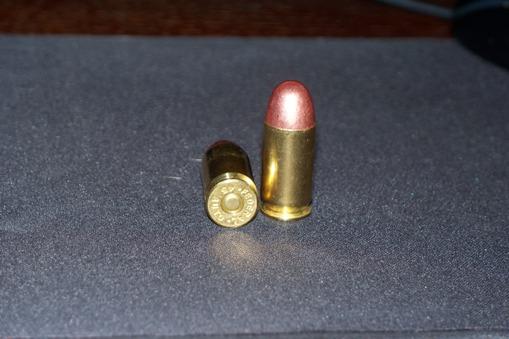

    I reloaded some (see post below) and had primer leakages. The only thing I can figure is that the case heads are" hollow" from rim to center where primer sits. I'm guessing that upon firing, the primer backs out to your breach face and allows some gas to escape. I think Federal is now owned by the same group the makes the Blazer ammo and while having a different names, the cases may be the same mfg. The case pictured appeasr to be "low" in the center where the primer pocket is.
