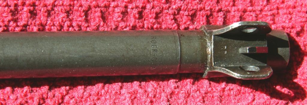

    I have this 1st picture saved in a file. I do believe from the cardboard background it belongs to the ' King of Maze ', aka MR.
    I don't have any other info listed about it.

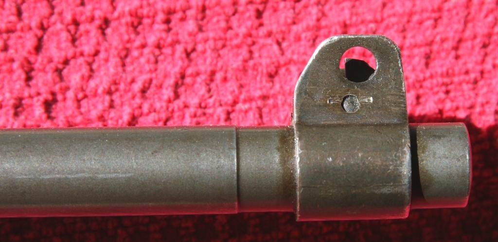

    2nd Picture,
    The Right site marked TR, is a loose one pulled from a RMC 1,71 that has type IA MR band.

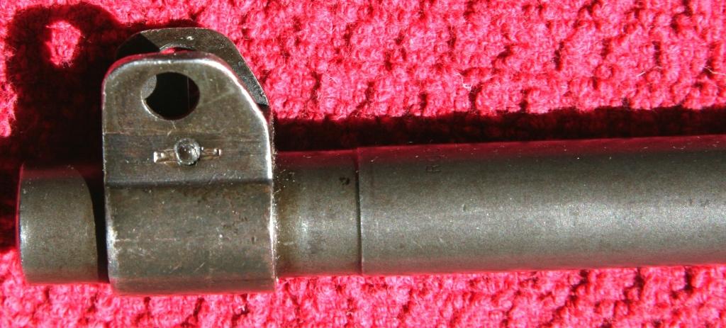

    3rd pic,
    Left one is the same TR, just showing the other side.
    FWIW The other site is WRA.
