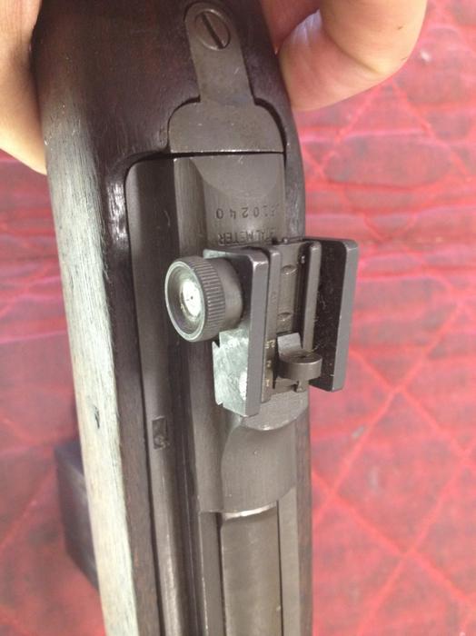

    My first M1 Carbine
    I recently acquired my first M1icon Carbine. It's a National Postal Meter receiver in the first batch of serial numbers, which I've gathered puts it between February and September of '43. Underwood 6-43 dated barrel, Winchester trigger group with a push button safety, first type modified mag catch, and Inland Type III bolt. It's got a rebuild mark from STD Products. And it's NOT import marked
    Here's a couple photos I took while I was inspecting it. I'll get some better ones up soon when I get my camera back
    Looks like some arsenal patch jobs on the stock too maybe

    Does it have a bayo lug? It looks pretty sweet. The push button safety is what they had in the beginning before being arsenal rebuilt. We need to see your barrel!! Does it have a bayo lug? I would like to see the front part of your stock also. You've teased me with those photos!!

    It does have the bayonet lug. I will get those other pictures you request as soon as possible

    Interesting plug repairs in the stock.
