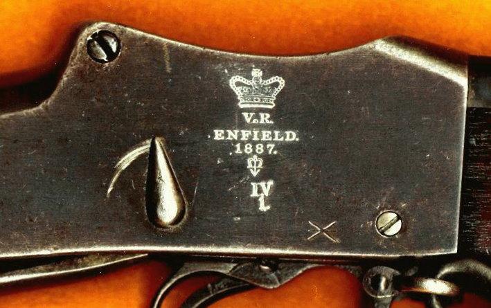

    I have owned this Martini mk4 marked for the NWMP, for around 20yrs. I know very little about it.
    I've seen one other of these, at a gun show in Oshawa, Ont yrs ago. I understand they were police sharp-shooters rifles issued in limited numbers to the police. I'm interested to find out any info on the gun, and would appreciate hearing any comments from anyone with any knowledge of these rifles.

    Did you mean to attach photos? If so, I am not seeing any. What sort of NWMP markings does the rifle have?
    If it is a Mark IV, as you say, I doubt if it is legitimate, since Canadaicon never acquired any of that model, to my knowledge. "Arms & Accoutrements of the Mounted Police, 1873-1973" indicates that the only Martini-Henry rifles issued to the NWMP were 10 Mark I rifles in 1874 and then another 10 rifles sent to Prince Albert by the Militia Department in 1895 for use in competitive rifle shooting by Force members. The first ten came from the batch of 2,100 Mark I rifles the purchased by Canada in 1873 (received early 1874) and the other ten could have come either from that batch or from the 5,000 Mark III rifles purchased in 1885. This circa-1896 photograph of the NWMP shooting team shows them armed with Martini-Henry rifles, which clearly do not have the very distinctive Mark IV receiver configuration and extra-long lever -

    I went and dug out the 3 that I have the Mk IV is so long I'd forgotten how long, the other two I have are the Mk III BSA in 303 and a Greener which has a much shorter looking lever, and what I have out.
    Anyway the branded mark is on the RH side of the butt marked N.W.M.P. POLICE, it's a MKIV 1 there is another smaller round mark behind the police stamping but I cannot read it. The wife say's she will snap it tomorrow morning. The M is not clear as something hit the stock at sometime in it's life, but the rest is very clear, and as typed.

    Sorry Ian, but the Sergeant in this photograph is not holding a Mark IV, although I realize you want to convince yourself that he is ...... Look at the size of the triggerguards in the two side-on rifle views I posted and you will realize that the "higher glint" in the old photo is light reflection only from the front curve of the triggerguard in the photo, the bottom and back curve of the guard are not reflecting light. The straight part of the lever starts about where I have put the white line.
    I hesitate to post further in this discussion, because you so clearly want to believe that your Martini-Henry Mark IV was North West Mounted Police issue. However, I regret to advise that the roundel in your photos is not an NWMP mark. You indicated that you feel this rondel says "N.W.M.P Police" but, to my knowledge, the Mounted Police have never used a combination of all of the letters in their abbreviated name with the word "Police" - it would have been either "N.W.M.P" or "N.W.M. Police". At any rate, it makes no sense that a small number of Mark IV Martini-Henry rifles be acquired for the NWMP when Canadaicon held over 7,000 Mark I and Mark III rifles .... most of which never saw military service, but were extensively issued or loaned out to both military and non-military competitive shooting teams.
    I am satisfied that this rondel in fact is "N.W.F.P. Police" - referring to the police force in what was the North West Frontier Province of Pakistan. (In 2008, Pakistan changed the name of the province to "Khyber Pakhtunkhwa", purportedly to get away from "imperial/colonial" connections.)
    Most of the other markings shown in your photos - other than the original markings applied at Enfield - show clearly that this rifle saw its service in Pakistan. For example, the "PAK" mark on the nocksform is well known as denoting service in that portion of the Britishicon Raj.
    Similarly, the R.P. mark on the buttstock is also a very well known mark denoting the arsenal at Rawul Pindi (the modern spelling of which is usually "Rawalpindi") -
    I expect that I have no real chance of convincing you, however ....

    Ian:
    My apologies for perhaps sounding a bit "snarky" .... but I was indeed getting the impression that you were unwilling to be dissuaded from what you had been told about this rifle. (I also realize that it might have seemed like I was talking through my hat when you had seen another Mark IV with the same markings, for which the same explanation was being given. However, if that rifle was indeed marked the same as yours, then it too would have been in service in Pakistan, and presumably its owner was simply believing a similar tale about it.)
    As I mentioned, no Mark IV M-H rifles are known to have been acquired by Canadaicon. I should add that you don't simply have to take my word for this assertion, but can rely on the extensive research of such people as David Edgecombe (C.F. Brig.Gen., Ret.) author of "Defending the Dominion: Canadian Military Rifles 1855-1955" (published 2003) who spent years scouring through all available Militia Department records, parliamentary and fiscal reports, etc. to produce his book. Mind you, I am not entirely without some knowledge in the area ..... here is how he autographed my copy .... ....
    To answer your final question, Mark IV rifles were not really ever issued to Britishicon regular troops, but rather only to reserve forces and also to native and colonial troops.
    It is relevant to review the circumstances and time-frame of the production and use of the Mark IV Martini-Henry. At the time it came on the scene (.... none were issued until 1888, if I recall correctly ....) Britain had already adopted its first bolt-action repeating rifle: the .303 Magazine Lee-Metford (shortly to become the Magazine Lee-Enfield upon a change of rifling design). While the new .303 rifle was in development, there was also yet another program under way to develop a reduced-caliber (.402") single-shot rifle with a re-designed Martini action - and this "Rifle, Enfield-Martini, Mark I" had actually gone into production (1887 I think) with some 65,000 rifles already finished.
    With the formal adoption of the new .303 rifle in 1888, many of the existing .450 Martini-Henry Mk I, II and III rifles in the hands of troops would necessarily have to remain in service during the changeover - i.e. until all Regular troops could be re-armed with the new repeating rifle. Also, in keeping with long-standing practice, Martini-Henry rifles would remain the standard-issue rifle for British reserve troops and also for "colonial" and "native" forces for quite a few years to come. Rather than having rifles in Empire military service chambered for three different cartridges at the same time (i.e. .450 Martini-Henry, .402 Enfield-Martini and .303 Lee-Metford) the entire Enfield-Martini program was scrapped before any of those rifles got issued (except perhaps on a "trials" basis) and the many rifles already produced were altered to chamber the existing .577/.450 M-H cartridge .... with the altered rifles being re-designated as the Martini-Henry Mark IV. Manufacture of this model continued until about 100,000 Mark IV Martini-Henry rifles had been produced in total. (In these circumstances, of course, all M-H Mk IV rifles were destined for issue only to reserve and "colonial/native" troops ....)
    As a matter of fact, in the receiver markings on the approximately 65,000 Enfield-Martini rifles converted to Martini-Henry Mark IV rifles, the "I" of the Roman numeral "IV" is centered directly below the arrow-point of the crown-and-arrow "lock viewers mark" underneath the date ..... because they had already been stamped as Enfield-Martini Mark I rifles. When they were converted to .577/.450 and their designation was changed to "Martini-Henry, Mark IV", a "V" was stamped alongside the existing "I" .... with the result that the "IV" is off-center in relation to the markings above it -
    Later-production rifles (such as yours), having been made after the .402" Enfield-Martini program was scrapped, were marked "IV" at the outset .... which is "centered" in relation to the markings above it ......
