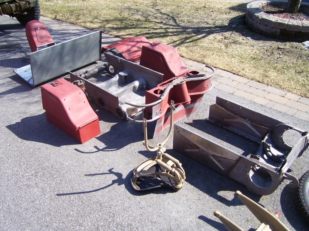

    The bone yard, nothing is discarded as the rusted panels hold a metric ton of information and measurements. In time this fine pile of historic rust went to Alberta, Hi Darcy.

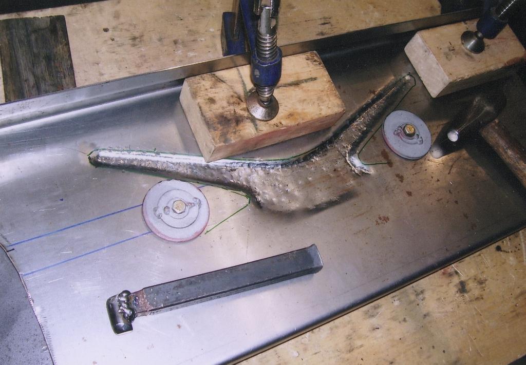

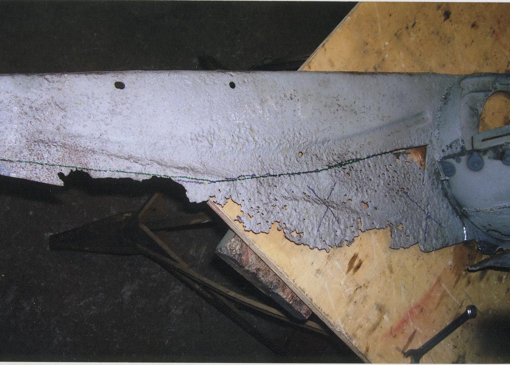

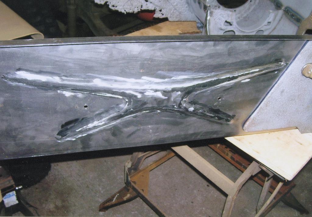

    While alot of the X area looks sound the sandblasting reduced most to lace.

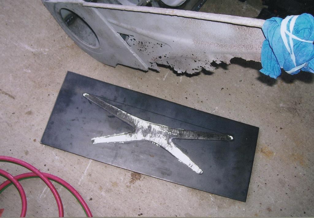

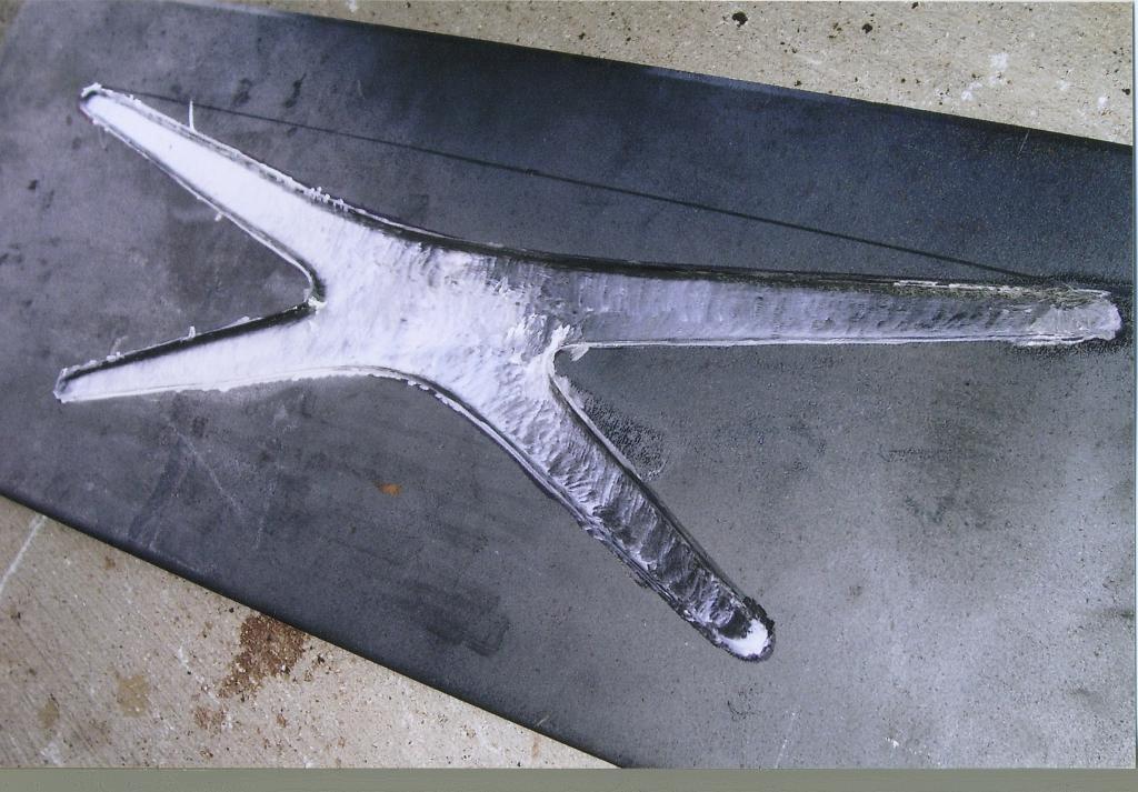

    To repair these panels I took a large 3/8in thick plate and using a angle head grinder (Bubbas favourite tool) and a Dremel hand carved a female X to replicate the X in a new panel. On one side I just replaced a rotted X panel with new and on the other saved the top of the X and mated a new lower portion.
    Hand dinging in the X to the new panels.
    Before
    After
    Saving everything possible, after the sandblaster did its thing turning sheet metal into lace, the cutting continues to be replaced with new steel.

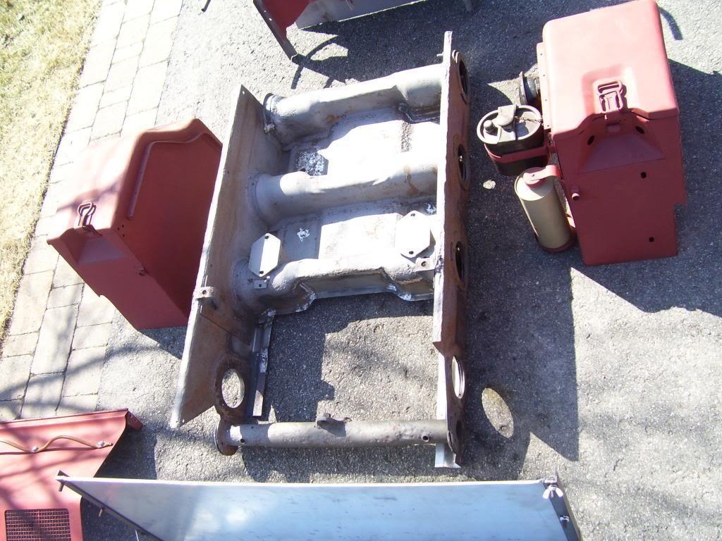

    The three major sections (lower front/rear and steering knuckle) the lower front shows the all new X panel and the restored (new bottom area) X on the opposite side.

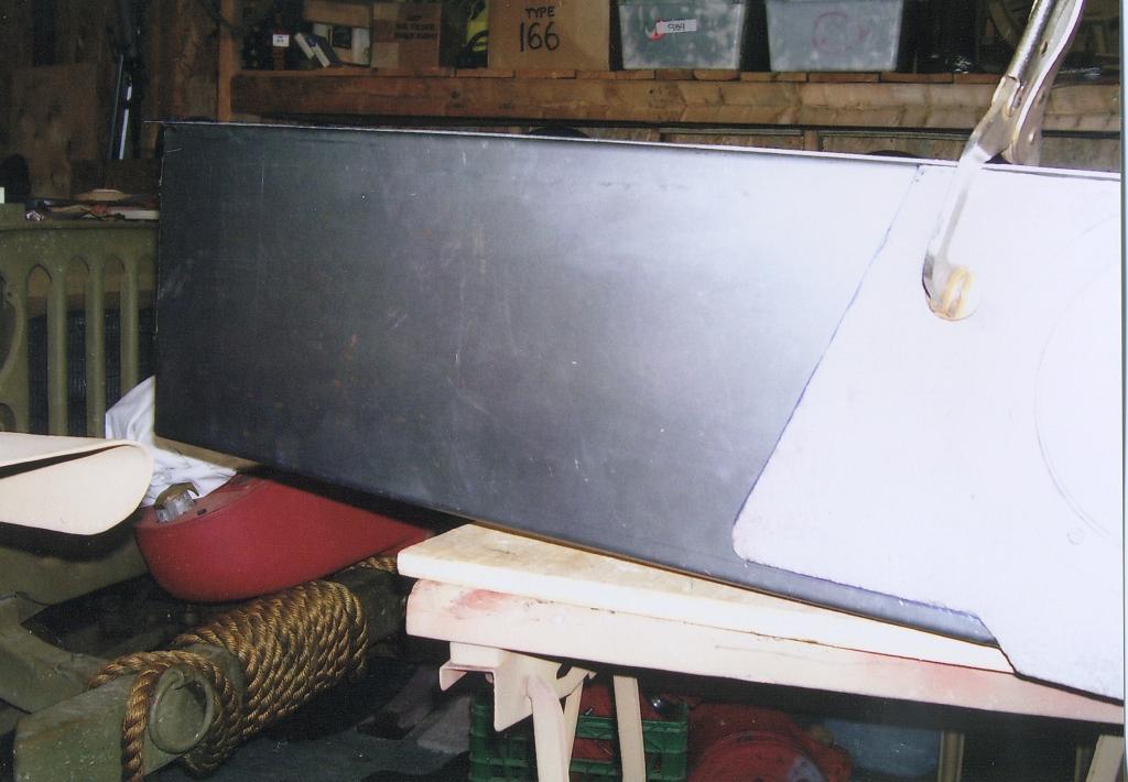

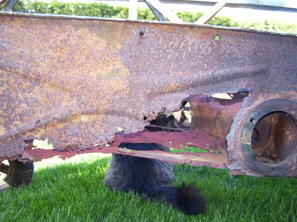

    So much ground to cover I had better pick up the posting pace otherwise this could drag on forever. The issues with the lower rear half where 1. the floor, with its unique square pressed portions needed heavy repair 2. the four inverted U shaped torsion bar houses all needed faberication and repair and 3. about 20 inches of the rear lower had simply rusted away to nothingness. This picture, while previously posted shows the rear end at Day One.

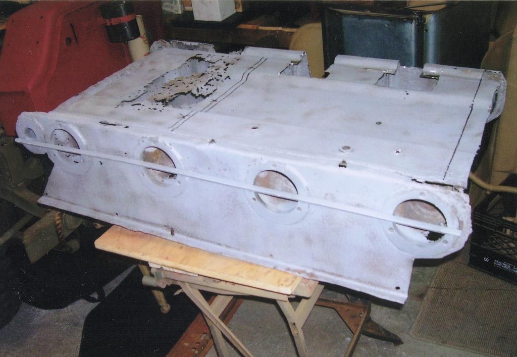

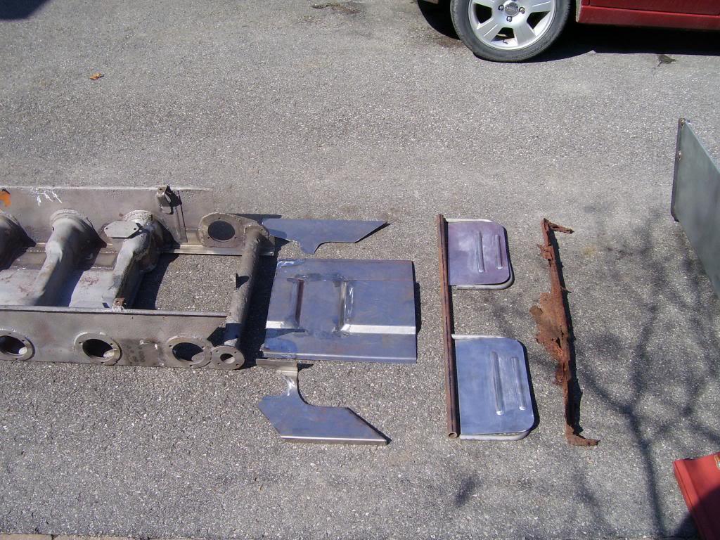

    Another previously posted pic showing the floor sections that need repair. Note the series of three holes punched in the body to drain the hull, Euro Bubba strikes again.

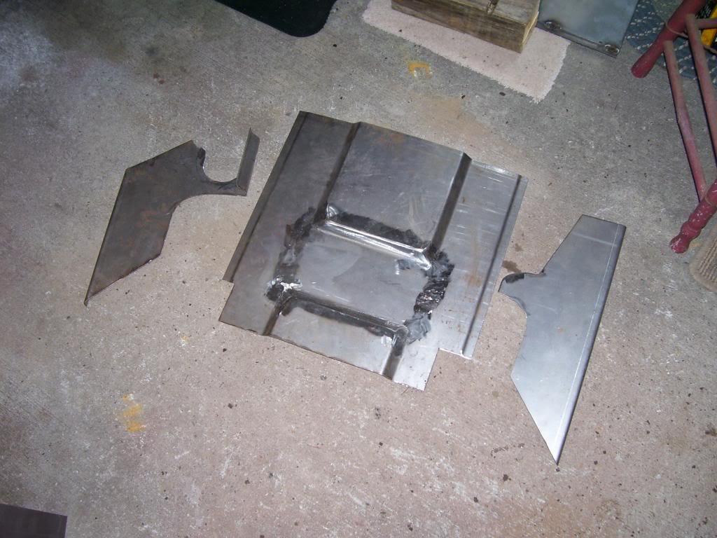

    After sandblasting and final chopping out of rusted areas I now see what all floor wise has to be replaced, plus sections of the sides to extend rearward past the track adjusters. The rear most, and insanely difficult to repair torsion bar house is out at this stage, the first three torsion bar houses where repaired without removing, that back one was just to far gone to do that installed.
    Lower rear floor and side sections fabericated. I had to resort to hotgluing chunks of rust together to get the radius of the side sections where the Kett muffler mounts off the residue to make new panels.

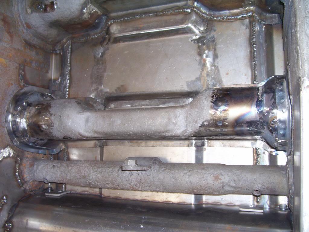

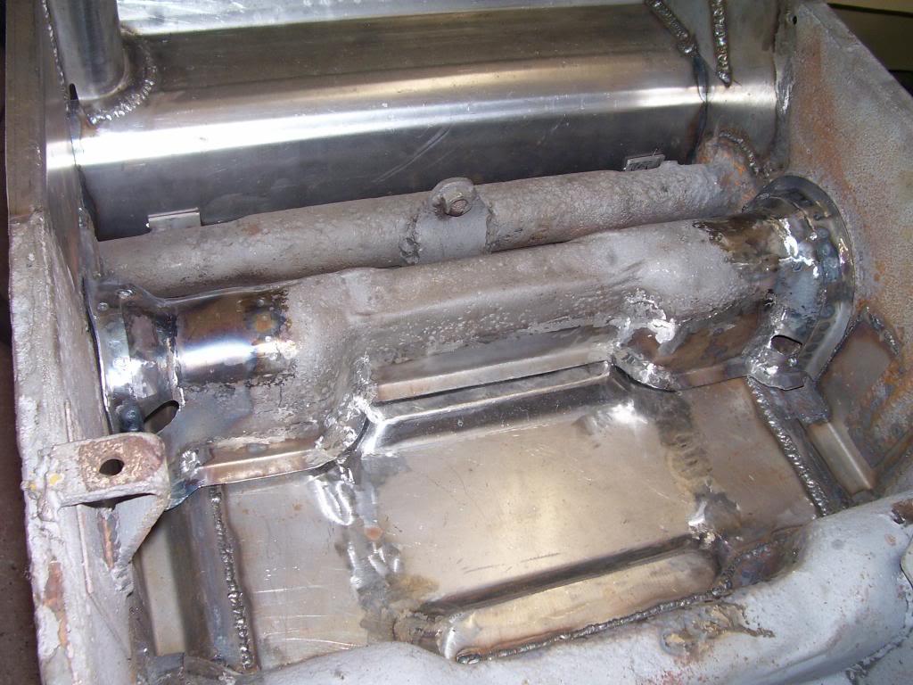

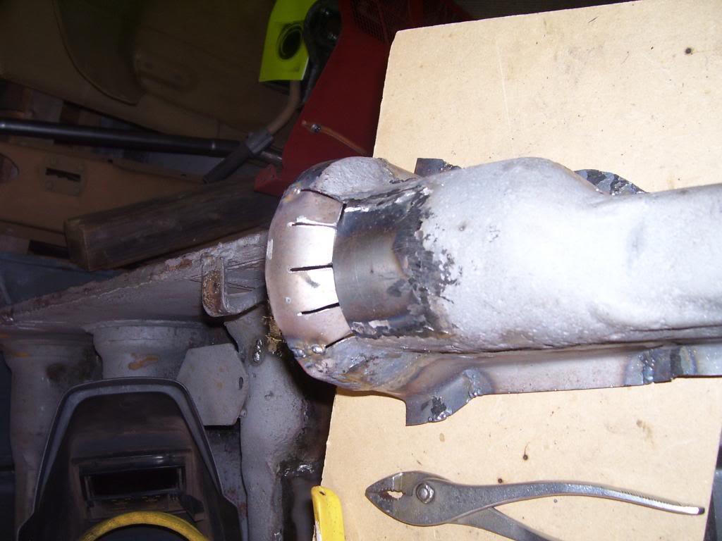

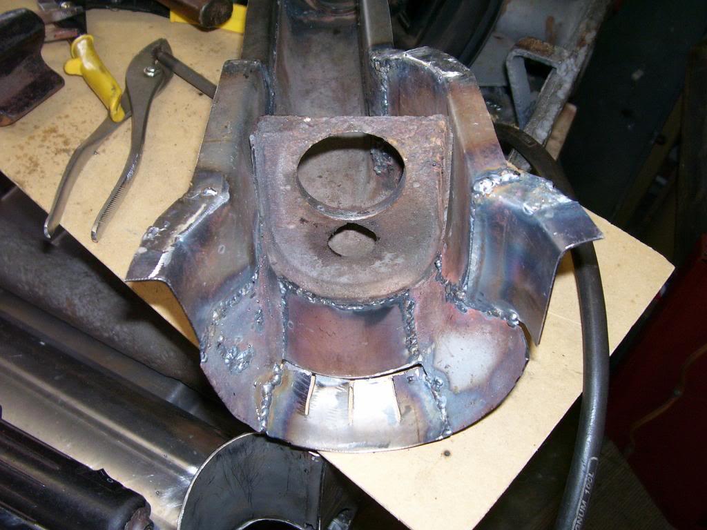

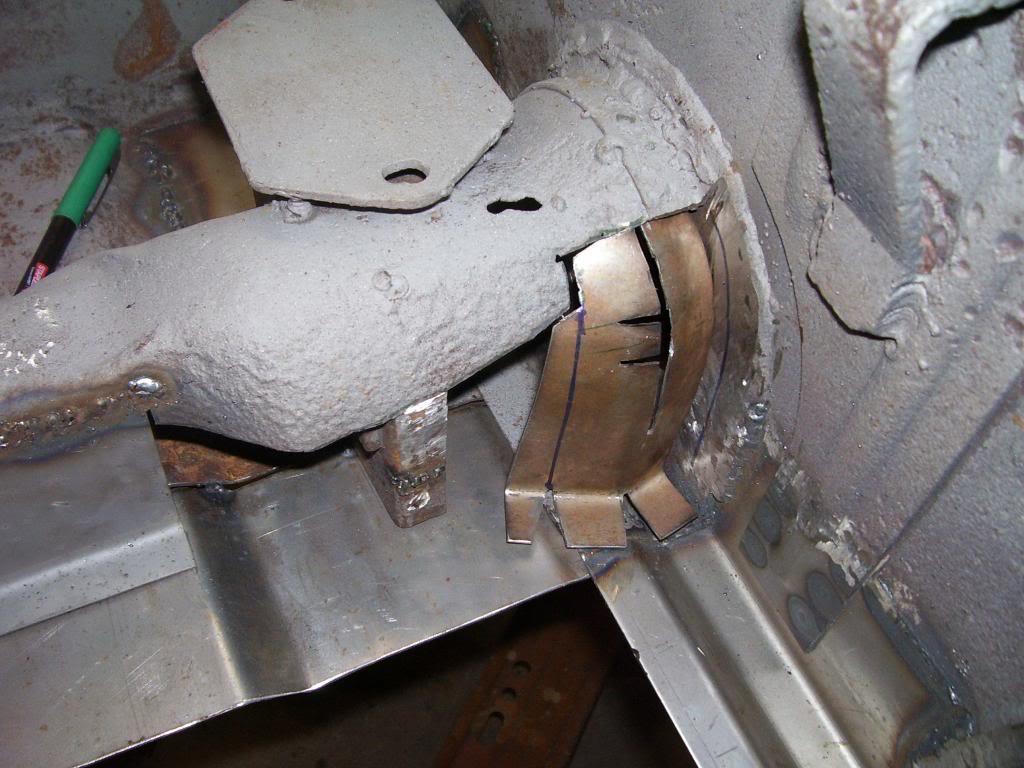

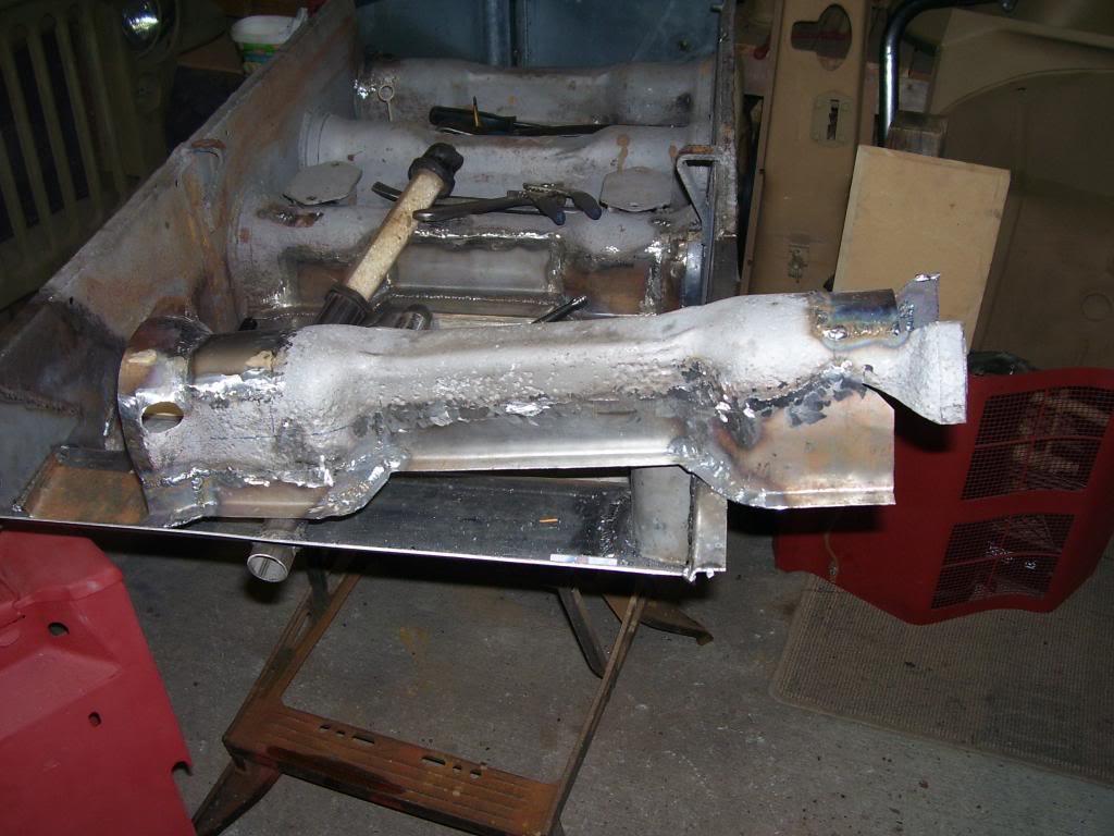

    Repairing #4 torsion bar house.
    To repair #4 it took 22 individual pieces fitted and welded into repair, then it had to mocked up with the carriers and torsion bars installed so the vehicle geometry was correct. I spent more time on and effort on that rear house then the other three.
    Cut and welding what felt like forever, one one part (good old #4).

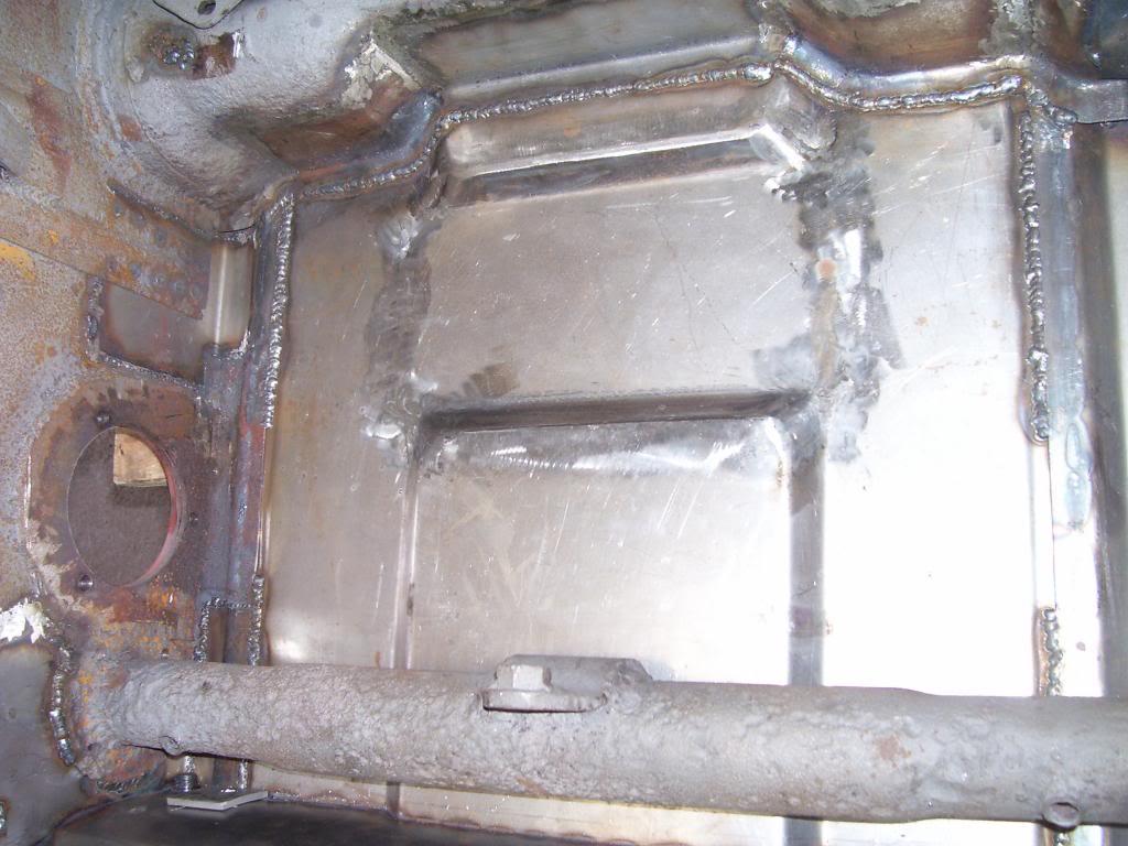

    Repairing houses without removing, section of mocked in floor to give correct profile.
    New made rear floor installed and next is replacing #4 house.
    Ready to weld in #4 house rear metal werk largely done after about a couple thousand test fits I get the new to fit nicely with the old and weld together.
    #4 back in, finally.
    Done.
