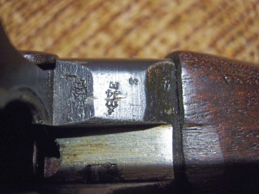

    I have just acquired a 1930 Enfield No 1 Mk VI. It has the original serial # crossed out with x marks and a new serial # 307 engraved followed by the letter A on the butt socket and bolt. The bolt does appear to have a different original serial # than the gun, but has the new # 307A. The barrel and mag have the same number followed by letter A. From what I've read, it should have flutes or grooves in the forearm, but does not. Also, the magazine cutoff was never there and the frame is not cut for it. Overall, the gun is in very good shape I'm not sure what I've got here, so I would appreciate some info from you guys. I'll attach what pics I have and try to get more. Thanks.

    Nice find! You have one of 1,025 rifles made. They are pretty rare. Some were reconfigured in the early part of the war to the No. 4 standard, with a new serial number and the "A" suffix, which signifies non-standard, non-interchangeable parts.
    The first issue of this rifle had a grooved forestock on the underside and sides, from the mag well forward, about 16 inches. Your rifle has been restocked, probably when it got the new serial number. Can you post additional pictures?
    These command a pretty hefty price when they see the light of day. From various website stickies, there are less than 25 in the USAicon. Of course, no one knows for sure.....

    Hey guys, I'm still working on more pics. I took off the stock and found cosmolineicon around the barrel and it does have the slot for the mag cutoff. It is however, missing the rear handguard band and the front band. Pics soon.

    Any chance of some full rifle photos?
    Would I be correct in assuming that they were re numbered at the same time (As in post Dunkirk) as the No.1 MkV and trial No.4s as all the numbers follow the same format.

    Here are the pics that I promised. This rifle will be for sale as I am not an Enfield collector. I would however appreciate your honest opinions about the value of this rifle.
