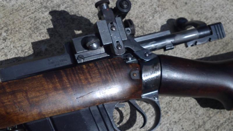

    Canadian DCRA 7.62 target rifle
    Good Day,
    There is a fantastic thread more than 50 pages long in the sticky section over at CanadianGunNutz.com. They have amassed over 1500 serial numbers and scattered throughout the thread are photo examples of many. I found mine (#1010) at a small show in SC a number of years ago. The globe front and rear sights are made by John Wilkes.
    Regards,
    Michael

    Quote Originally Posted by FlightRN View Post
    Regards,
    Michael
    One of my Whitaker Specials has a Swing rear sight on attached as per you're picture FlightRN.
    Essentially it's a Wilkes sight but George Swenson who invented the Swing worked for Wilkes. My best guess is that they were not patented and Svenson copied them, or possibly bought them unmarked from Wilkes.
    I also like the way you're tunnel foresight has been brazed into the foresight protector. Thunderbox on here has one we were looking at this Wednesday at Bisley. It strikes me as a far better arrangement than just fixing the Matchmaker onto the sight block.
