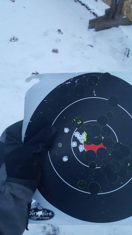

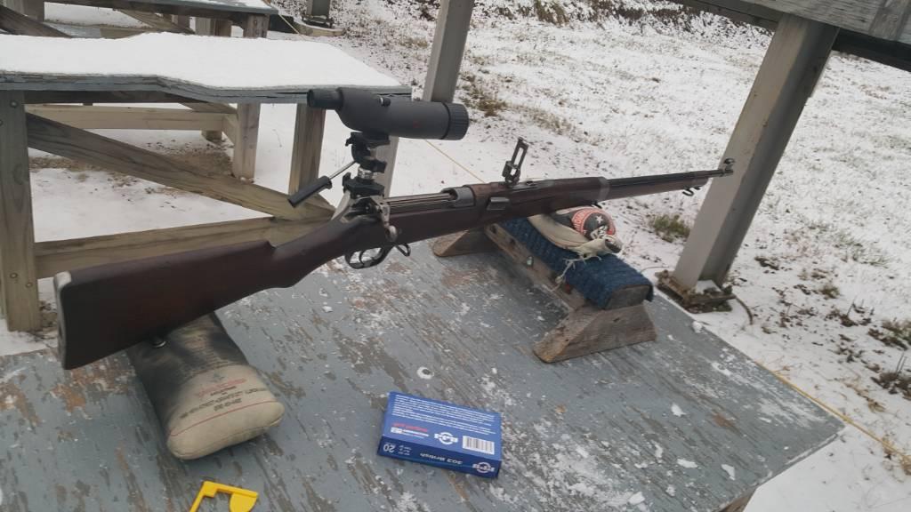

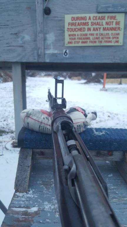

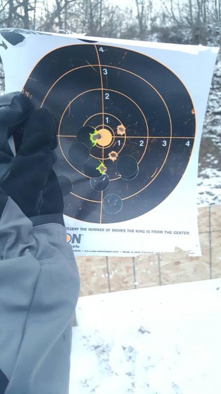

    I just shot the 1905 today. I was able to get a little 100yd range time in after work but before it got dark.
    Sooo what's this about the thin 1905 barrels not being accurate?? I was rather blown away by its accuracy, especially considering the following factors:
    1. It was low light. It was hard to get a consistent sight picture.
    2. I was using factory PPU ammo with the intention of fire-forming brass.
    3. The trigger is pretty stiff and probably needs to be cleaned up a bit.
    I shot two groups, a 10 shot and a 5 shot. In the 10-shot group 8 of them are inside of 1.5". The two flyers are almost certainly me or the ammo. The 5 shot group is still good but a bit less impressive as the light got very low.
    One very notable thing was the very minimal case stretch compared to Enfields. That blew me away.
    I can't wait to try my neck-sized hand loads in good light after cleaning up the trigger assembly. And the expectations have certainly been raised on the 1910!!!
    Just awesome rifles.

    Quote Originally Posted by Gustro79 View Post
    Just awesome rifles.https://www.milsurps.com/images/impo...45842e77-1.jpghttps://www.milsurps.com/images/impo...02778680-1.jpghttps://www.milsurps.com/images/impo...88a8f2bc-1.jpghttps://www.milsurps.com/images/impo...43f56eef-1.jpg
    Correction on case stretching: the body of the brass shows almost no stretch but the shoulder moved forward and the neck opened up considerably.
