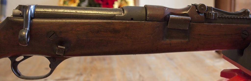

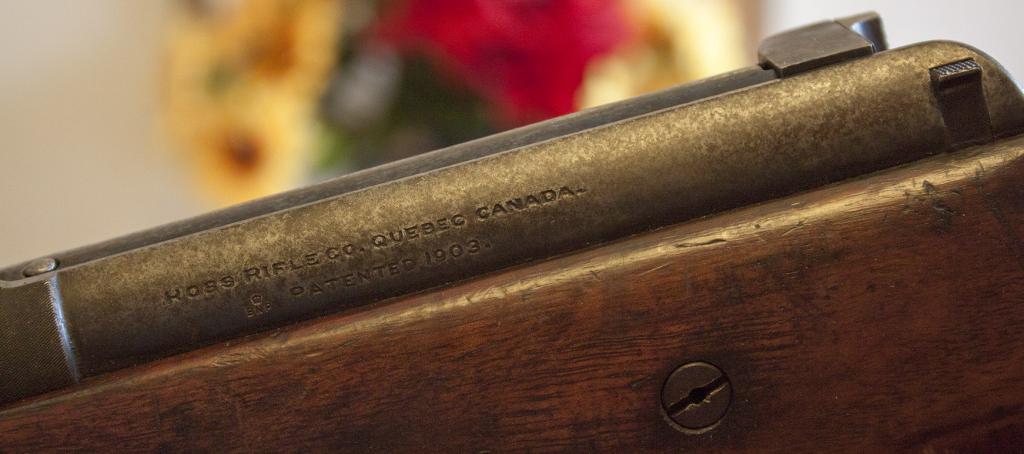

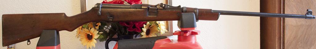

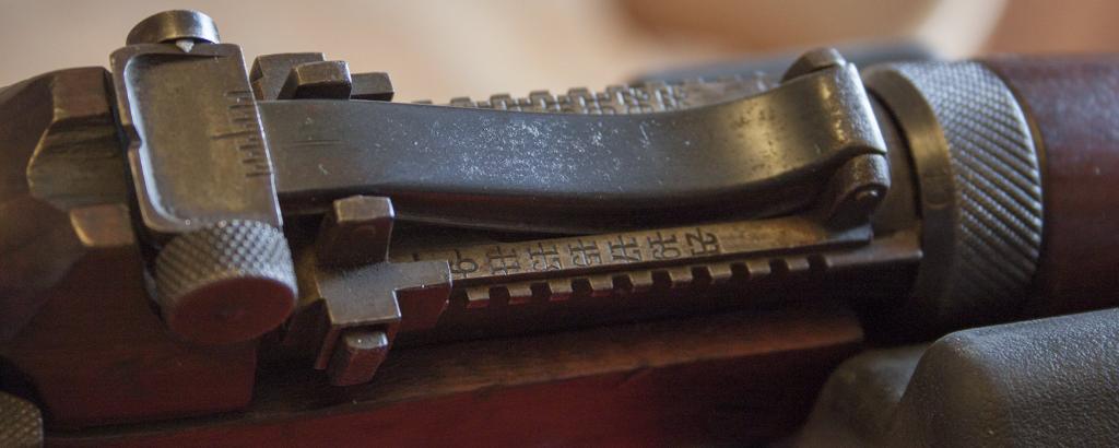

    I picked this rifle up today and I'm in the process of cleaning it. It was sold as a MKI, but seems to have a few MKII features as well and very little in the way of markings.
    The bolt is bone dry and takes quite a bit of force to operate. I can't figure out how to dissemble it beyond locking and unlocking the bolt head, and removing the extractor.
    Here're some photos of the bolt itself. I'll photo the complete rifle soon and post that up as well - it's survived the past century quite well.
    Thanks very much.
