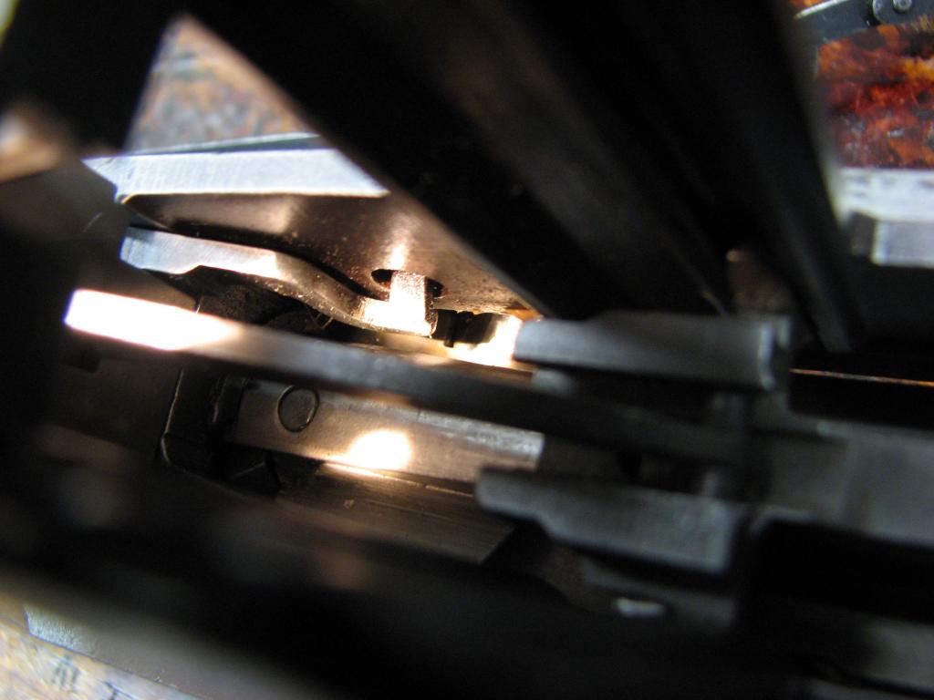

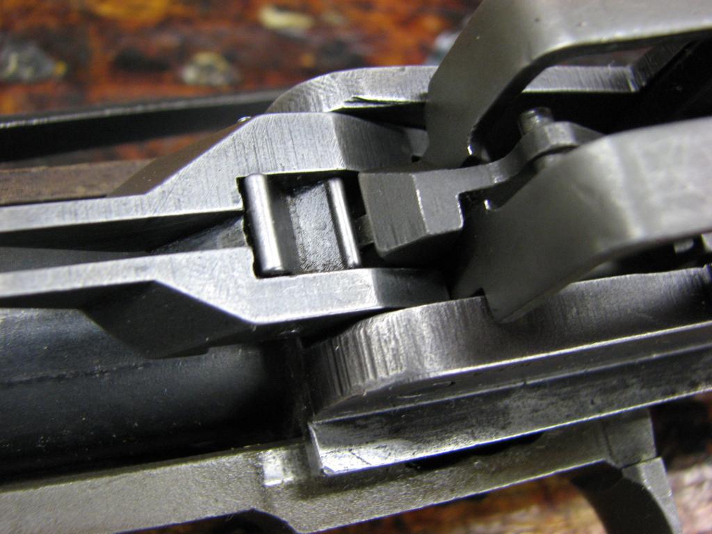

    You have the follower arm in the wrong potition on the accelerator or bullet guide tab on top of accelerator instead of under. Rick Bicon
    ---------- Post added at 08:01 PM ---------- Previous post was at 07:57 PM ----------
    After I thought about it more Ive seen the arm on the op rod catch not properly under the Bullet guide release tab. Rick B

    Rick, thank you so much! You pinpointed the problem. Your picture really helped. The operating rod catch was pointing down and catching the operating rod when I tried to pull the bolt back. I played with the operating rod catch until it was level with the pin installed and everything worked!
    I really appreciate your help my friend!
