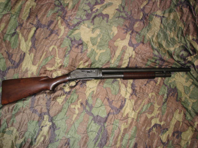

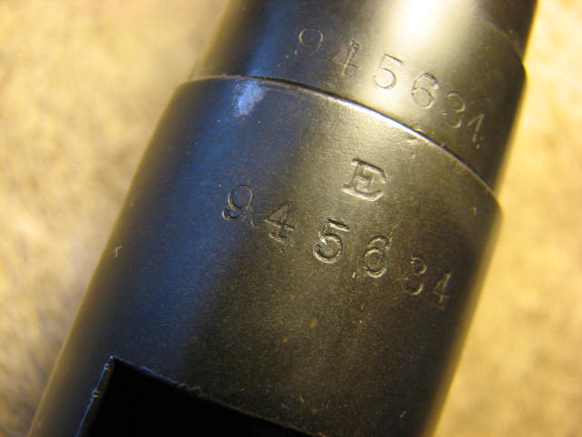

    WINCHESTER WWII M97 RIOT GUN

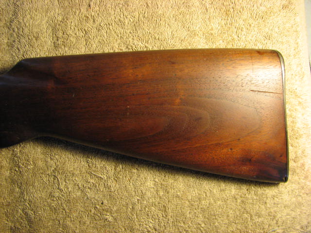

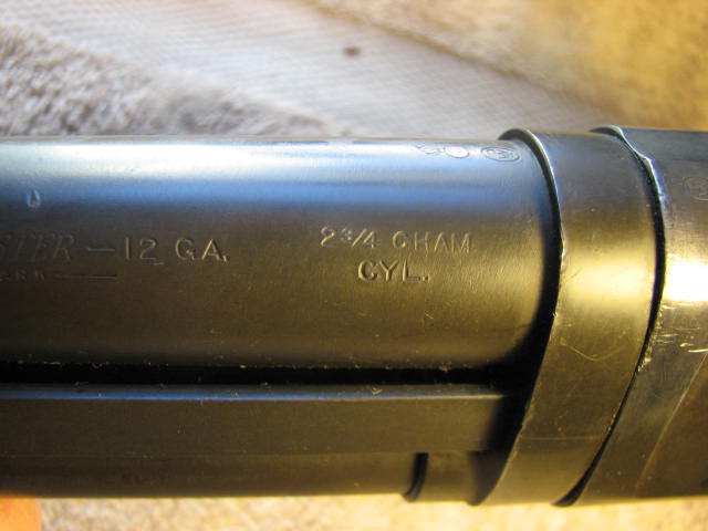

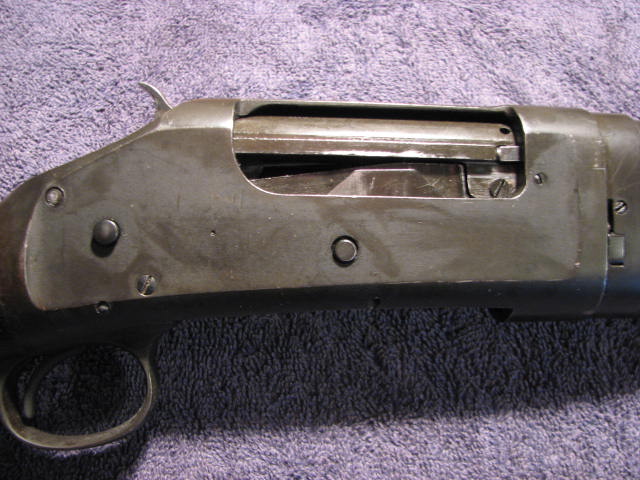

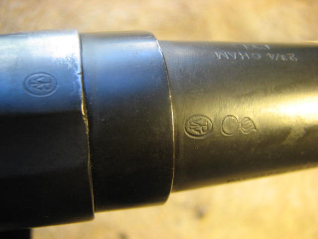

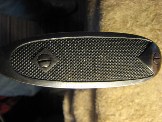

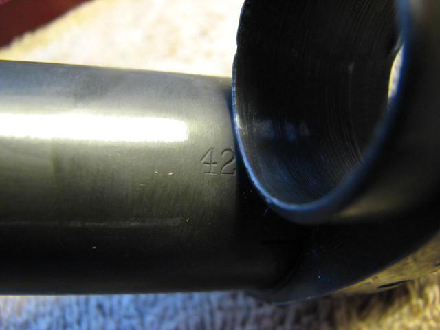

    I'm new to the Forum and have many questions about my WWII M97 Riot Gun. It was purchased back in the late 80's if I recall correctly. It displays the correct "US" and Ordinance stamps in the normal locations but no cartouch on the stock. It displays "42" under the barrel in the proper location however the butt plate is steel not plastic. The finish is parkerized presumably over the original blue and very uneven or blotchy.

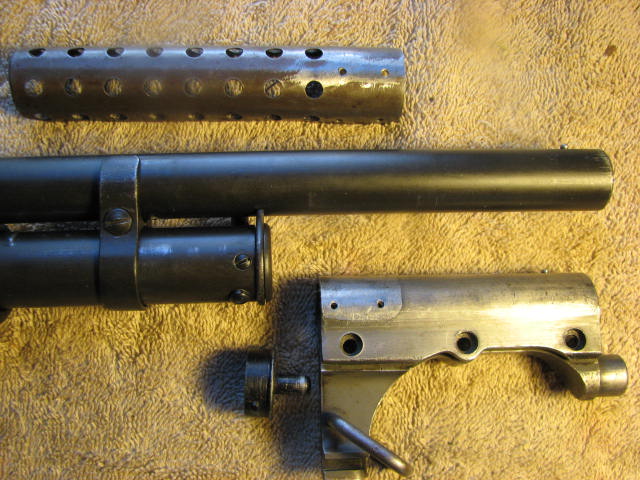

    I feel confident it's mostly all original but the metal butt plate and lack of stock cartouch is confusing. I'm interested in converting it to a Trench Gun and have an original "W" marked bayonet adapter and mag plug but no usable hand guard.
    It would be most appreciated if the more experienced and educated than myself on M97 Riot and Trench Guns would offer comment and possible advise.
    (Photos are available but don't see a means here anywhere on my post to download them.)
    Thanks for any advise and suggestions.

    I would suspect the butt may just be a replacement. I'm not sure it's value will be retained by changing it to a trench but it's yours, so... Pics would help some to identify it's place in collectables. Also we'd love to see it.

    I read the butt plate could be an earlier version but that doesn't explain lack of any arsenal rework cartouch. All that being said, including an even, blotchy parked finish has diminished my interest in retaining the original Riot Gun value that much. Also, many Riot Guns were converted by the military to Trench Guns anyway. However, I won't do anything to it yet at all at least until I confirm a bit more possible detail information.

    Ah HA...! Finally broke the code on loading photos....please see the first post and note in the attached photos to what I'm trying to refer to.

    Splotchy park like that usually suggests a poor job of stripping blue off before parkerizing. Or the other way also...a good fine bead blast before refinish next time will sort that out. Then a good parkerizing...

    I thought about re-parkerizing but the bead blasting would probably would reduce the depth of the proof marks and such more than would be worth it,

    Silica glass beads don't abrade, that's sand blasting that removed metal. We've done lots of glass beading that cleans out marks and enhances. Use a fine silica glass bead...
    Sarco shows a repro, perhaps you could pilfer the ventilated part and spot them together? Don't know how good they are.
    Winchester 97 Trench Gun Bayonet Lug Heat Shield With Screws (W97058)
    Then there's these, I had one in hand for Mod 12 and they aren't bad. https://www.partsforantiqueguns.com/winreparts.html
