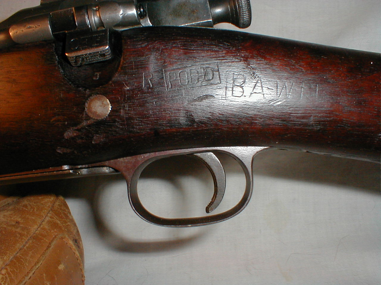

    I have a 5 digit Rock Island with a 1-19 AV Barrel. Looks like it was rebuilt after WW1 it has a BA W rebuild stamp and was sent to the Philippines because it has a POD D stamp on it. There are no other rebuild or inspection stamps on it. What are the chances that if it was sent to the Philippines in the 1920s or 30s and would have still been there iat the beginning of WW11

    Being far from an expert on these marking, i believe the P.O.D. with inspector letter is pre WW2 and the BA - WL is a WW2 inspection stamp. I have seen the following P.O.D. M, P.O.D. D . I have some data on a Rock Island 196xxx serial range with 6-11 dated barrel marked P.O.D. B BA-WL. My P.O.D. is on a four digit Springfield with SA 1918 dated barrel.
    It would be difficult to prove if your rifle came back from the Philippines after WW2, although it has been said that some rifles (M1903) were imported from there during the 70's?

    this Rock Island is 7i536 I figure the 1- 19 AV barrel

    BA and POD sort of go together.
    Benecia was the portal to the Pacific so I see a lot of times shipments of rifles from BA going to the Philippines, or coming back to BA from the Philippines.
    The other caveat in this is, even with the cartouches on the stock, it's nearly impossible to say when the stock was mated with that rifle.
