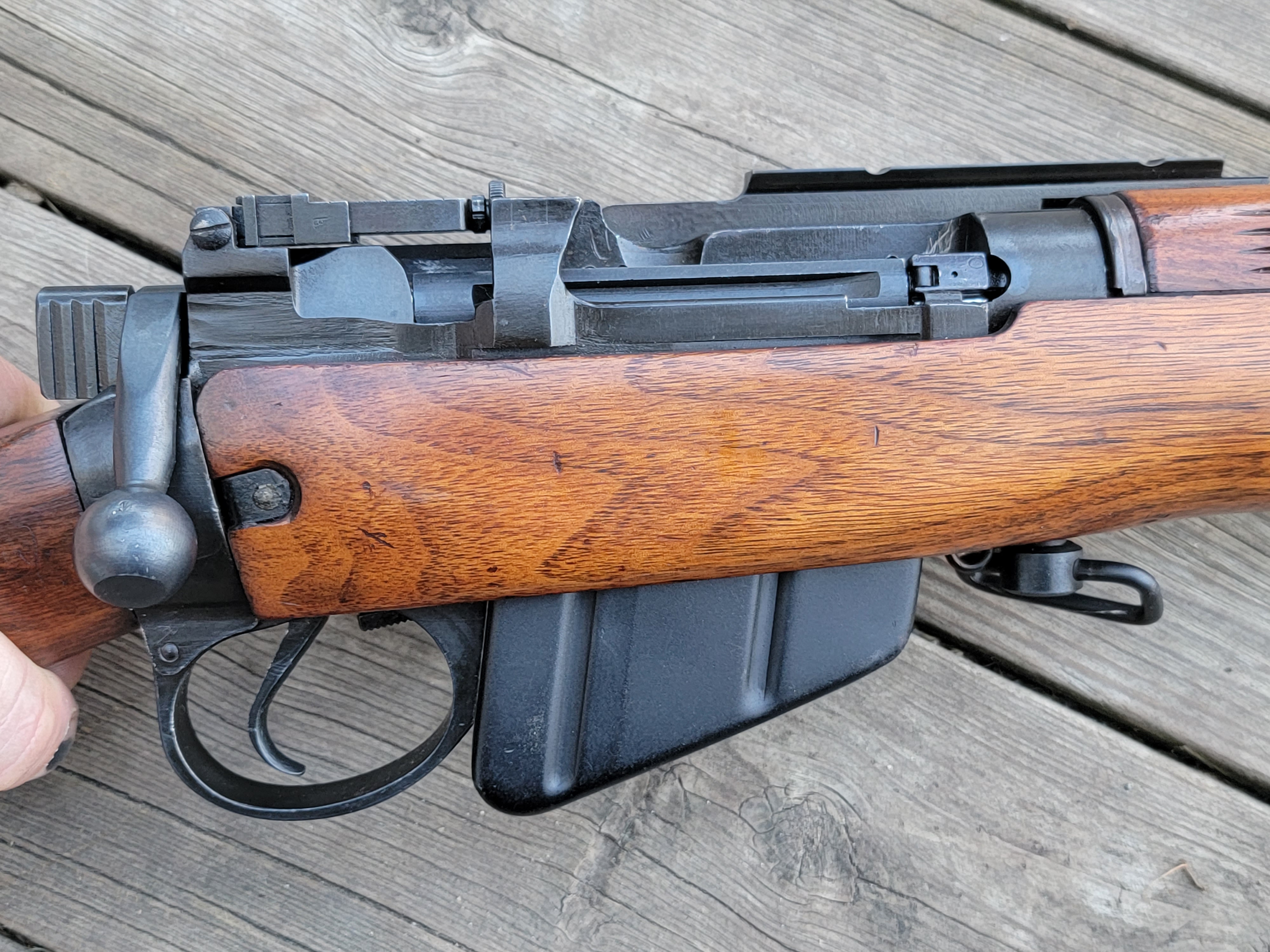

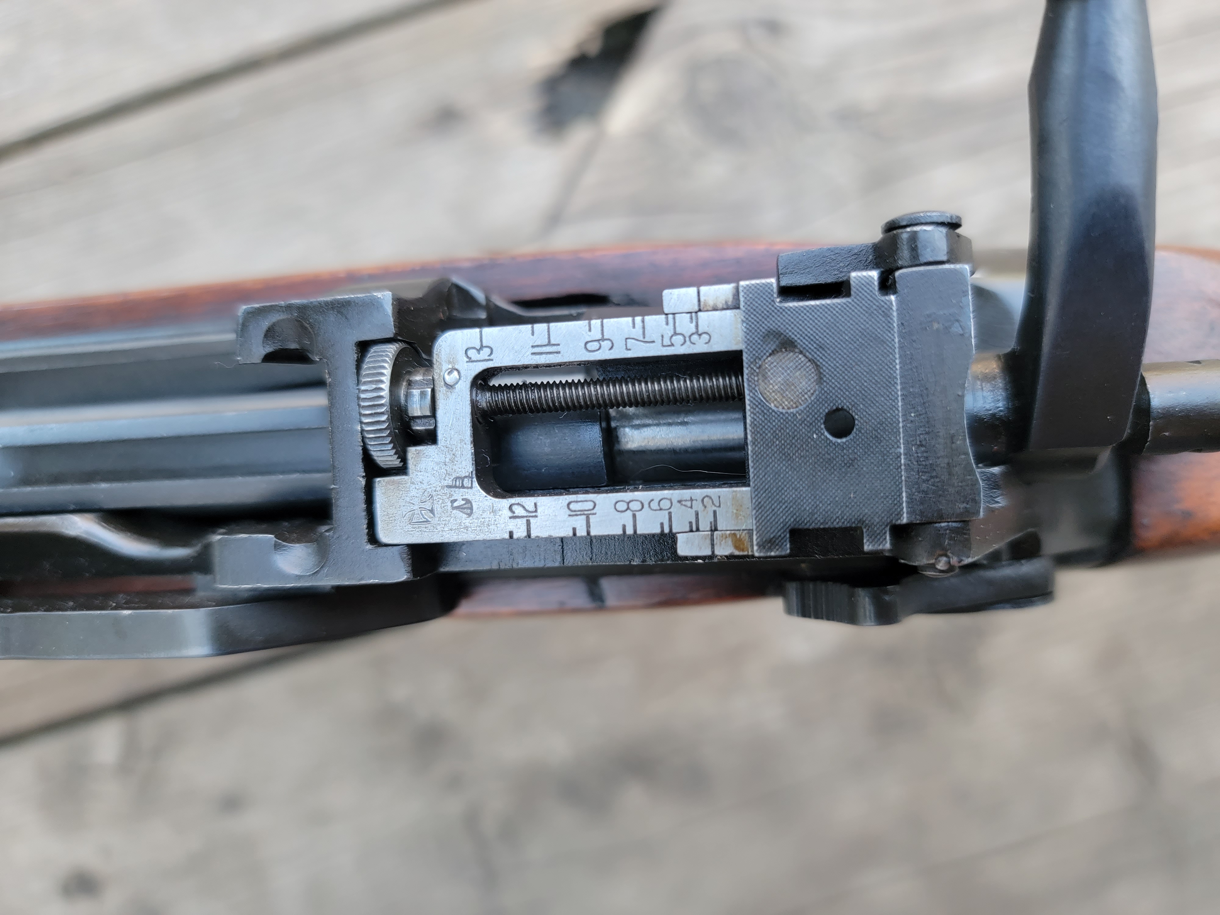

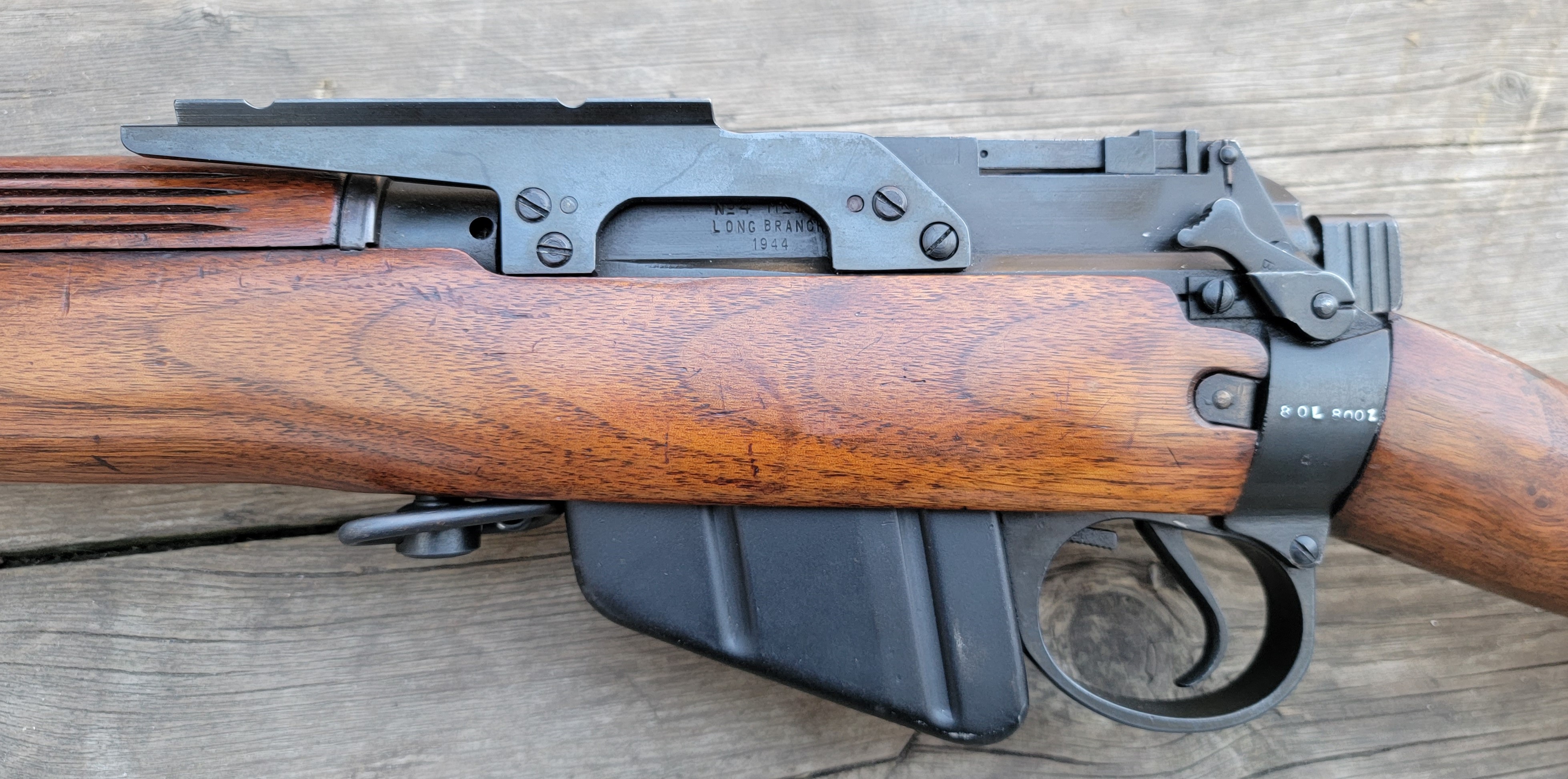

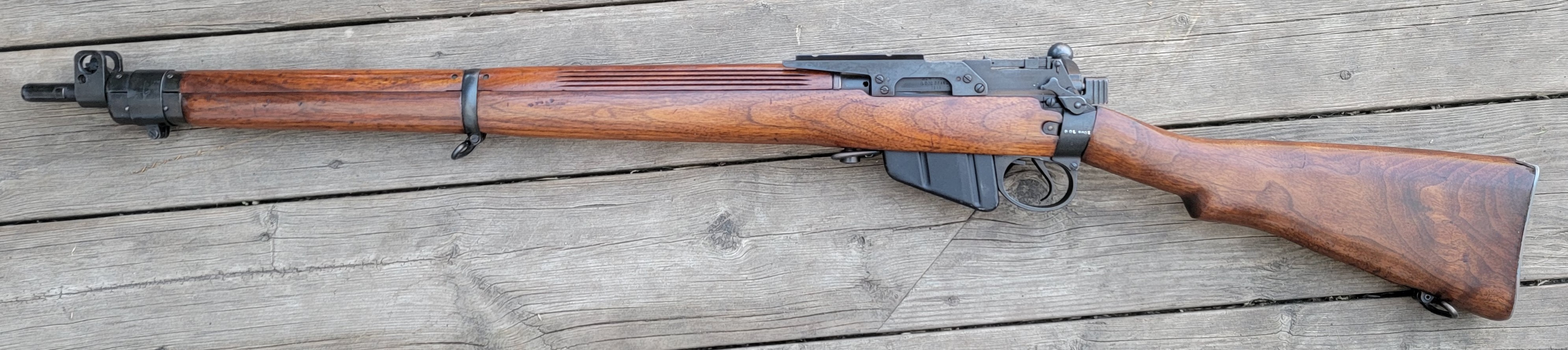

    here is my 1944 Long branch no4 mk1* sniper rifle. this rifle is like new and the 0 bolt head looks brand new, the barrel appears to have never seen a box of bullets. it has a beautiful long branch stock set but from what i was told by Colin Stevens when i sent him pictures, the furniture was replaced at some point and is not original to the rifle. Unfortunately it does not have a rail or the no.67 mk1 scope. i would love to find the correct original parts to restore the rifle to orginal configuration but i understand the parts are very hard to come by, if you have any leads that would be appreciated. if anyone has any information on these rifles id love to see it as there isnt too much out there.
    edit* tried to upload pics but had no success.

    Lovely rifle. I misunderstood at first - I thought your mount base was missing, but it is indeed present. All the better!

    I'm a bit confused, it looks more to be a TP sniper than for the C. No. 67 scope? Or what am I'm missing?

    At a glance the mount bases look similar between the TP rifle & the CNo67 rifle. The mating angle for the CNo67 mount is horizontal, but that for the TP rifle mounts is angled. Never measured it but suspect it may well be 45 degrees.
    This rifle has also had its typical set of wood removed & swapped for some regular LB woodwork, which again may make it look rather like a TP rifle. However, the serial number gives you a nudge in the right direction.....;-)

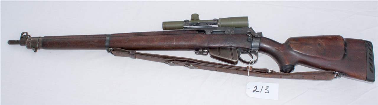

    Roger, how would the rifle correct to it had looked like? I've had a tough time to find a reference to those. The Canadianicon "Scout Sniper" rifle with the C. 67 scope in the Knowledge Libraryicon looks too different from this one.
    Today @ 08:16 AM
    out there
    1,861
    04-29-2025
    04:06 PM

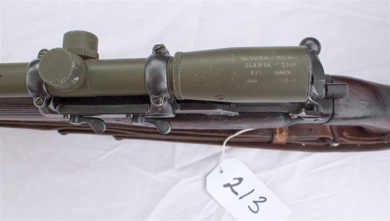

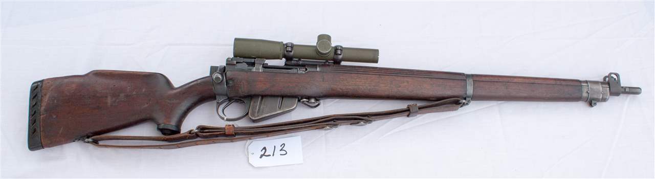

    On a C.No.67 scoped rifle, the only unconventional thing about the woodwork is the butt stock. (pics from the recent Bruce Gorton estate auction in NZicon)
    and if you have a Jostam pad on your stock - it's a fake...

    Could you expand on that please?
    Exactly what I said. SAL manufactured a "Clone" of the Jostam pad for the sniper program.
    A good sign of something being hinky is a Jostam pad in this circumstance.
    They used a different commercial pad (not sure how exclusively) on the trials rifles.
