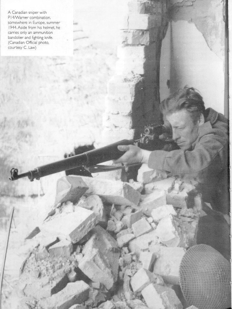

    Does anybody have an image of the Rifle No. 3 with the Warner & Swasey scope. These were former P14 Enfields that had surplus WW I Warner & Swasey scopes mounted on them and used by the Canadians in WW II.

    Quote Originally Posted by Riter View Post
    I just uploaded a photo such as you seek. Haven't used to photo service on this site before so I am not sure how to pin the pic to this thread it is in my gallery (only one) and it is entitled "Canadianicon Rifle No. 3 w/ WS Scope"

    There is another image of exactly the same rifle JGaynor had posted. It is pretty obviously this rifle uses the same rail system as found on Ross Rifle and M1903. The Britishicon though had a drawing for a mount which was very different from what we see in the two pictures of the same rifle.
    West side
    5,019
    05-09-2025
    09:45 AM
    Clive Law dealt with this in his book: the 1st Canadianicon Division took something like 80 loose W&S scopes with them when they went to the UKicon in 1939/40. Apparently new bases were made up for fitting to P14s, but we don't yet know when and where.
    The rifles were still on issue in 1943 and the Canadians took them to Italyicon, despite their flaws - one of which is on display here: lack of eye relief. The photo is posed and if the rifle was fired as shown the shooter would lose an eye.
    One can see from the surviving photos how few No4(T)s had actually been converted (or issued) up to late 1943: the No.4(T)s shown are usually either trials rifles or other early production rifles, and this accords with the inventory of sniping rifles on issue in late 1943. As I recall there were few more No4(T)s than the 1400 trials rifles; the balance was the 421 Alex Martin P14s and the remaining No.3 Mk.I(T) rifles not lost in Franceicon in 1940.
    I suspect something happened to interrupt production early on: in later 41 or early 42, wherever it was. That or a decision was taken somewhere in the Ministries to "make do" with what was already on hand "until later". "Later" soon arrived in the form of Italy and then Normandy loomed and suddenly the rush was on?
    Meanwhile No.32 Mk.I's cheerfully rolled out in their thousands and went into storage somewhere.
    I think there wasn't much left. After all they gave Northern Ireland the remaining stock of those, and even these weren't enough, so BSA set up additional rifles.
    BTW, I don't think he'd loose an eye. That eye relief is how it is supposed to be with W&S scopes.
    I owned one of the 500 Canadianicon issue W&S so have some idea whereof I speak. Like any scope without excessive parallax, you could hold your head back and use less than the full FoV and still hit the target, but if you had your eye fully up into the eyecup to get the full FoV, you'd better have a rock-solid hold on the rifle or you'd be -----d.
    And that is why as we can see in old photos, snipers sometimes cut the eyecup short; it's only useful function was to exclude light or fool you into thinking you could put face into it and come away unscathed.
    But there are worse; the Alex Martin scope that was fitted to a couple of prize L.E. Mk.I's circa 1900 is basically a theodolite beautifully mounted to the side of a rifle and has about zero eye relief! How that ever got past the "experts" of the time I do not know.

    I neither see any sense that quantity would change qualification of my reply, this was more a reaction to your claim that you once owned one of those and based on this said:
    This lead me to the reply that I have personal experiences with these scopes myself, to mention that I do have first hand experiences myself, plus the simple fact that what you said is wrong - the shooter will NOT loose an eye when firing the rifle.
    Though please now let us get back on topic since this discussion is not what the original poster has asked upon.
    Yes I did, No.310 as I recall, in the case, but could post photos if you want supporting evidence for my "claim"
    Have you fired a Ross Mk.III with W&S scope mounted?
    As for the P14s with W&S mounted, I've posted before that I have reliable reports of one on the loose here in Canadaicon in the 1960s. My guess would be that it was brought back by a soldier or a battalion as IIRC a document posted here previously refers to a Britishicon requirement that non-No.4 sniper rifles be turned in to stores as No.4(T)s were issued to replace them in late 1943 and early 1944.
    From that we can conclude that either there were not sufficient No.4(T)s on hand to equip the Canadian Army sent to Italyicon, (quite likely in view of the comparative absence of No4(T)s from the late 1943 inventory) or they chose not to turn in the non-No.4 sniper rifles, presumably on the grounds that more would always be better, and since nothing better had been issued after two years of marking time in the UK, probably nothing more would!?
    AFAIK, no collector in Canada has publicly stated that they own a P14 with W&S scope and that would tend to suggest they were all(?) scrapped. If by chance the serial numbers of those 80 odd scopes should ever show up on some document, we could at least determine if any of the 30+ known survivors from the 500 W&S scopes are among them, and that would in turn tell something about the fate of the rifles as almost all of those scopes have been found in Canada.

    I own two of the Canadianicon W&S telescopes and a dozen more US W&S scopes of both models with the same eye relief and overall are five of them on rifles I own, therefore I also do know what I speak of. The shooter will not loose an eye as you had suggested. It is uncomfortable shooting with the rubber eyecup but they do not poke you in the eye.
