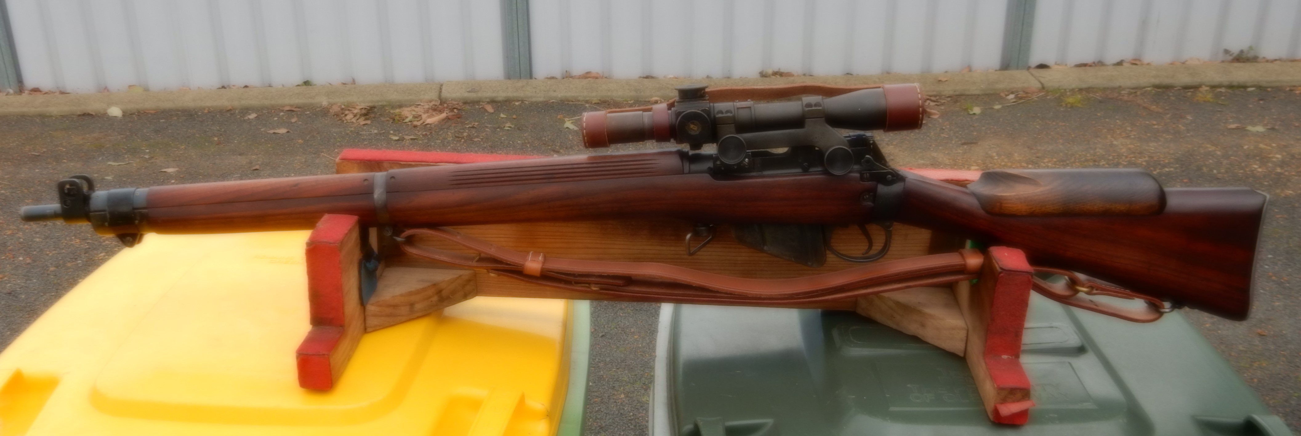

    Roger can you ascertain from the pic what wood my T is stocked in it's by all accounts according to the records from what I have learned here a Sept 1944 build with it's original as issued MkIII No.32 scope.
    AFAICT it has not been FTR'ed as there are no stampings or electro pencil markings on it anywhere to signify that event in it's history, the scope end covers are a repro.
    TIA
    TIA
    What prefix serial number is it, as I reckon mine was made around Sept/Oct '44 as well. Mine is a L prefix serial number, and has its original matching Mk.3 scope and bracket, and woodwork. Mines not been FTR's either, although its not got its original barrel.

    Cinders, I'm sure that's walnut, although stained birch can sometimes look quite similar, especially to lighter shades of walnut.......but that's walnut. I suspect that your cheekpiece is quite possibly ash (ash looks just like oak to me, but I gather we do not use oak on rifles due to the chemical constituents rotting iron over time!).

    Thank you for that Roger.
