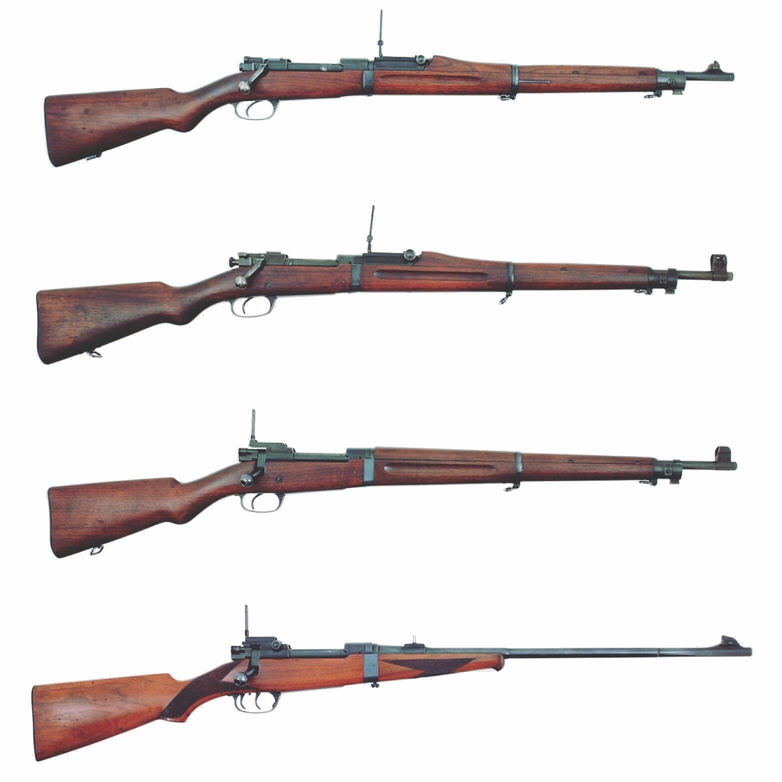

    Here some more of the Winchester test rifles - Winchester also planed them in .303 brit. and in 6,5x58 (the Verguerio-Rifle).
