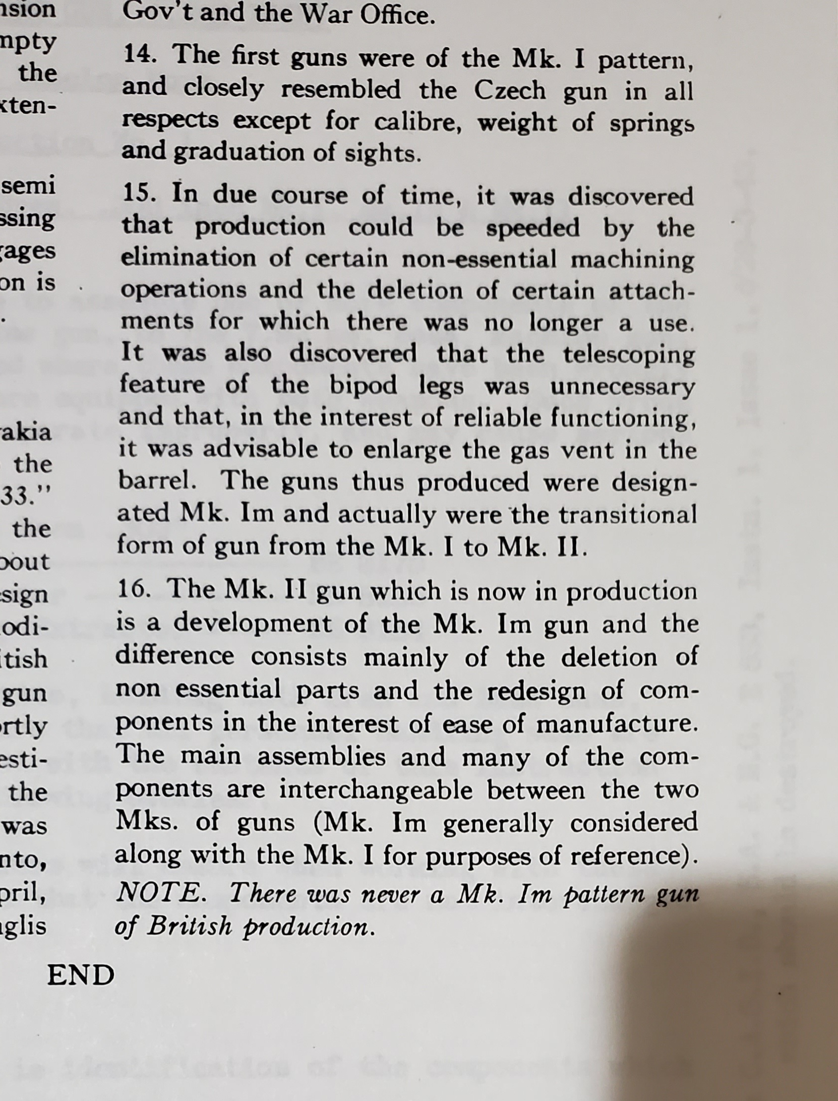

    Here is the explanation from the Canadianicon EME Precis on the Bren dated 11 Oct 1944.
  6. The Following 4 Members Say Thank You to Lee Enfield For This Useful Post:

    Quote Originally Posted by Lee Enfield View Post
    Attachment 131185
    So although not explicitly stated, the "M" presumably refers to "Modified", as per the modifications that text refers to?
    Is the text correct in implying that the Czechicon-built guns also had the dovetail for the Sight. Fixed Line & No.32?

    The enlarged gas port in the barrel was developed long before the Mk1m gun. This didn't change the actual GUN designation. It did change the BARREL designation from Mk1 to Mk1*. But I could be wrong.....
