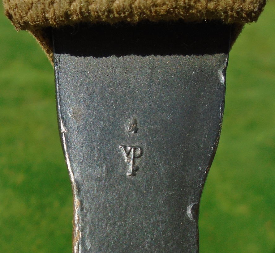

    Hi Daan, I actually already secured an action cover. I am told this is one made by (or atleast contracted by) Savage. Here is the pic off the ebay listing from when I bought it:
    I have heard you can find this marking on other canvas goods, but I haven't really found many photos of other similarly marked gear.

    Well done. So a Savage sling might not be that impossible.

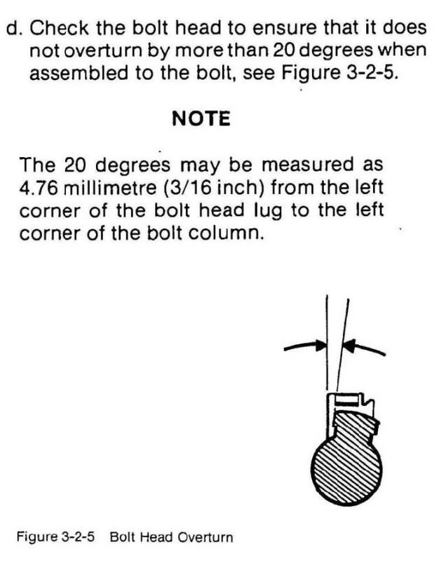

    It is pointless setting the headspace before grinding the locking lugs, as, when you do 'hand fit' the locking lugs it will affect the headspace.
    As important as headspace is bolt head under / overturn, so need to ensure that the bolt head clocks correctly, and THEN ensure it meets headspace specs.
Name:	Bolt Head Wear 1.jpg‎

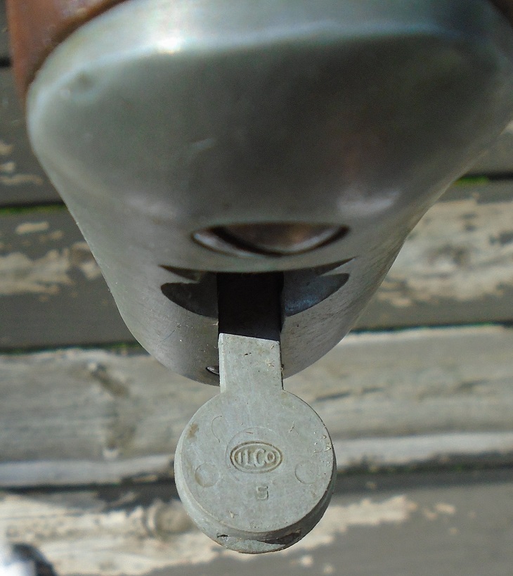

    You could look for a junkmetal buttplate marked "ILCO" which I think is Illinois Lock Company. A Victory Plastics (New Hampshire) scabbard/frog combo would be nice. Don't know about the sling.

    Thanks for the excellent close up there on the buttplate, Steve! Now I have a lead. That's a very cool scabbard and frog; currently my bayonet is riding around in a very nice but un-maker-marked stamped scabbard with the usual metal button for the frog. Yours is a totally different configuration and very interesting. Something else for me to keep an eye out for.
    Thanks!
