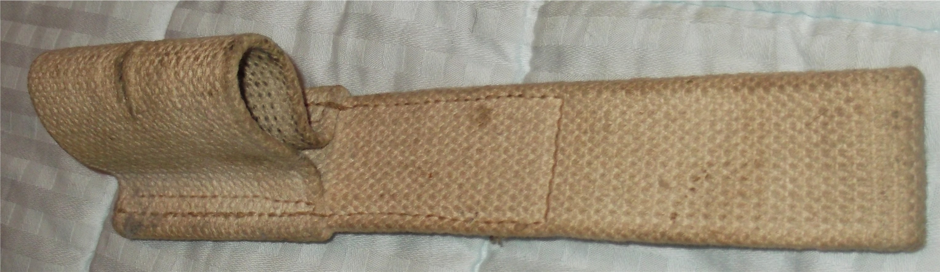

    I think that would be a matter of opinion and what frogs the battalions happened to have. As long as they weren't for the #4 spike they would fit the scabbard and they COULD be fitted, you could find them issued. I would think the ones used last that carried over to the #5 carbine and the FN bayonet/SMG bayonet would be most appropriate.

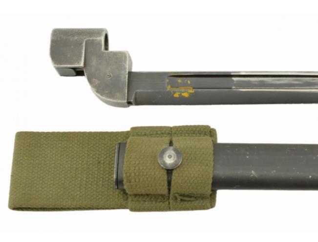

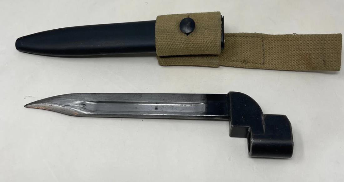

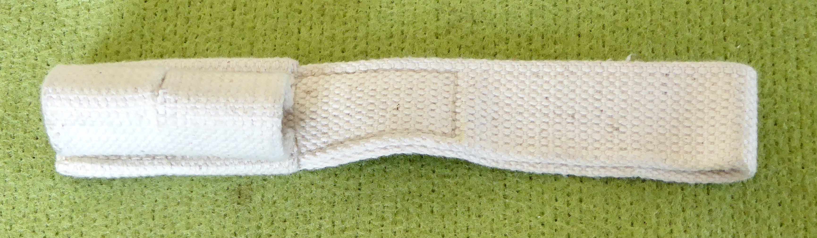

    The No.6 frog was introduced for the No.9 bayonet in 1954, with only a single loop, and the slit made wide enough for the frog button to pass through. White versions were made for the Navy and for the Household Division.
Name:	No 5 scabbard frog.jpg‎

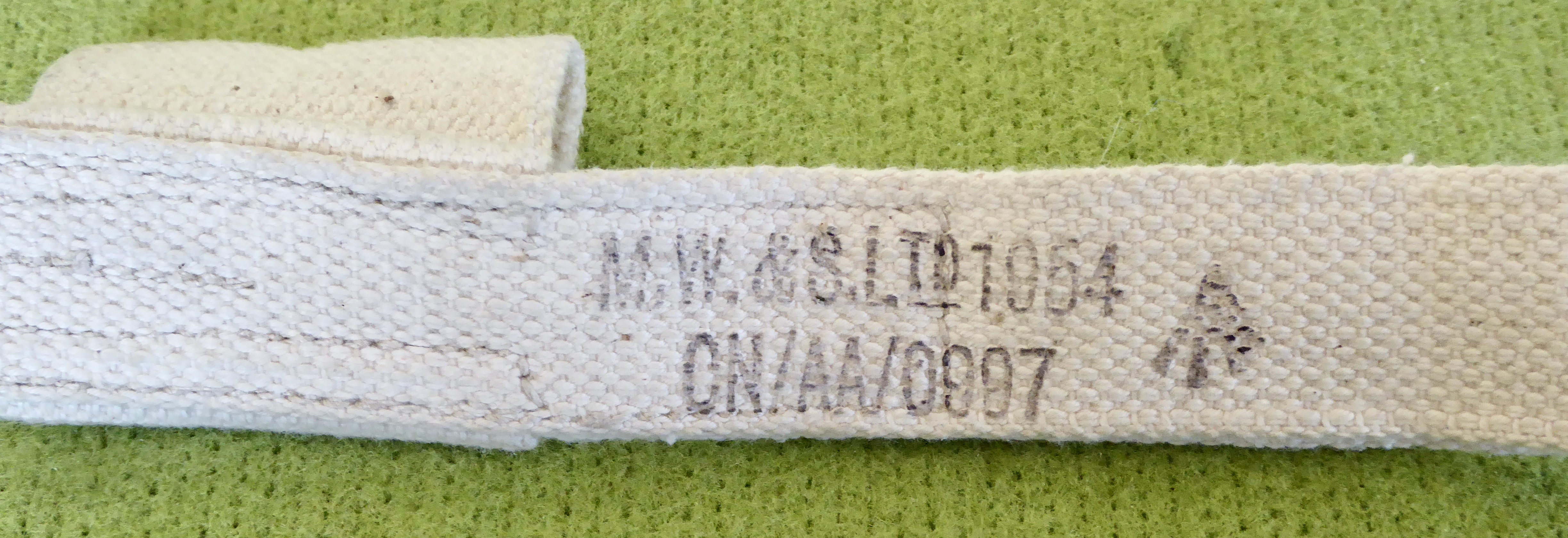

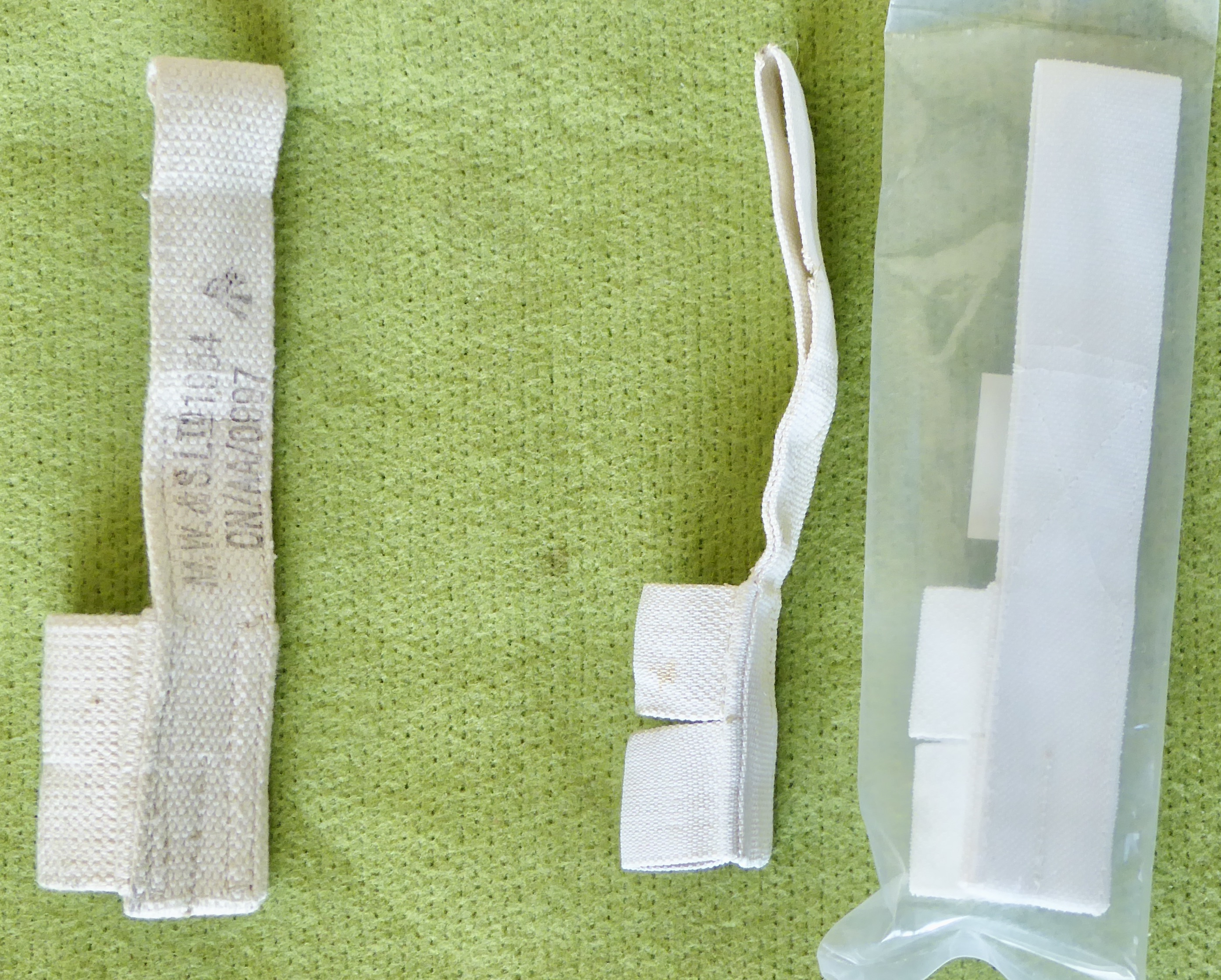

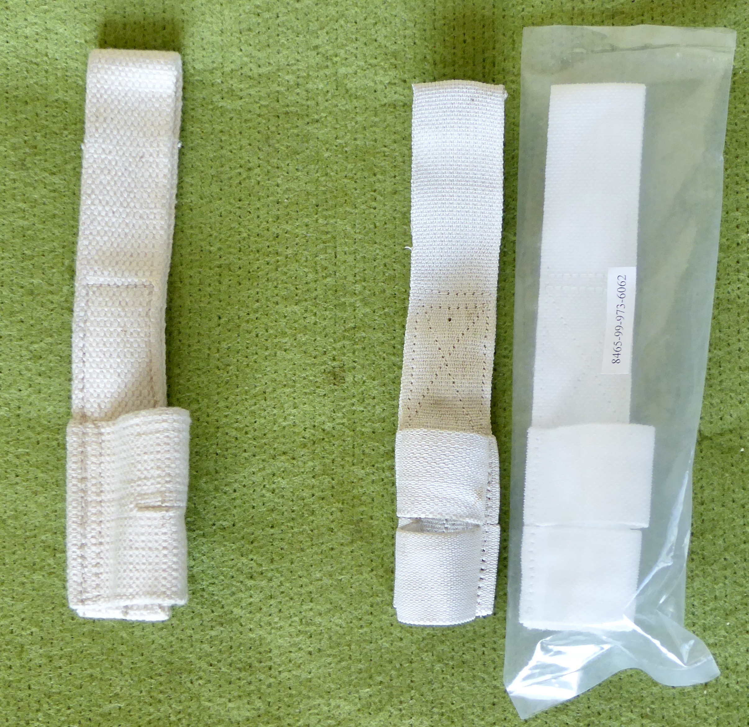

    Were frogs, slings and belts issued in white.........? Please tell me!
    Among the various frogs in my militaria collection I only appear to have 3 Britishicon examples in white, i.e. white from manufacture and not blancoed white. Only one of those is in webbing material, unissued condition, with the other 2 in nylon, presumably for the L1A1.
