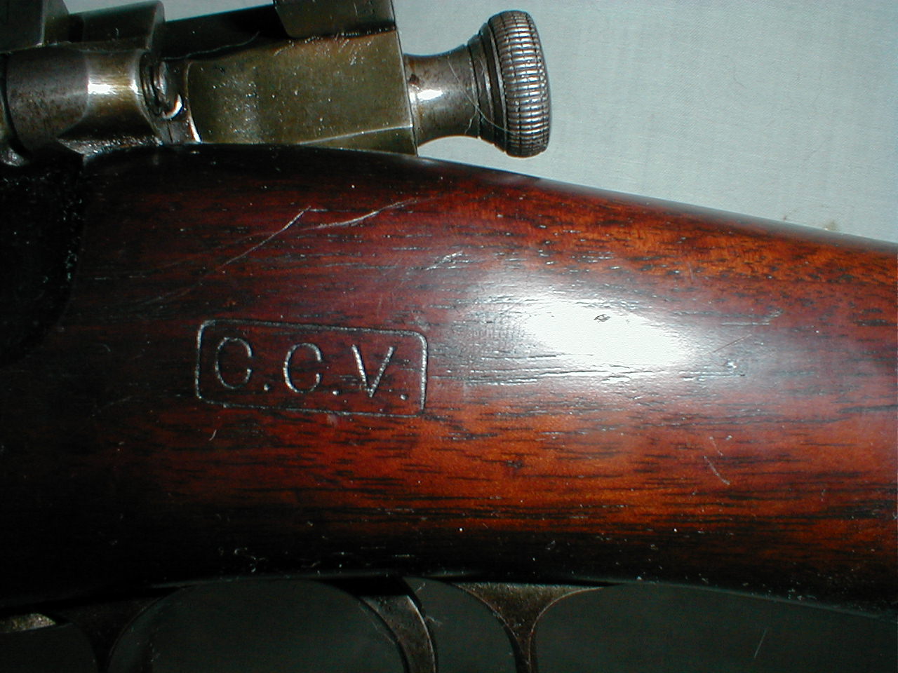

    I can't answer all your questions, but I will post some commentary.
    While it's certainly possible that your rifle was not altered until 1913, a more likely scenario is that your rifle was altered by 1910, then subsequently re-barreled in 1913.
    One can only speculate how the rifle skipped service in WWI and WWII. The rifle may have been purchased by a military officer after being re-barreled. Or the rifle may have been issued to the Coast Guard or some other entity where the rifle sat in a rack or saw limited service.
    A CV marking in the stock may be the partially obliterated inspection stamp of Charles C. Valentine. He was an inspector during that period.
    J.B.

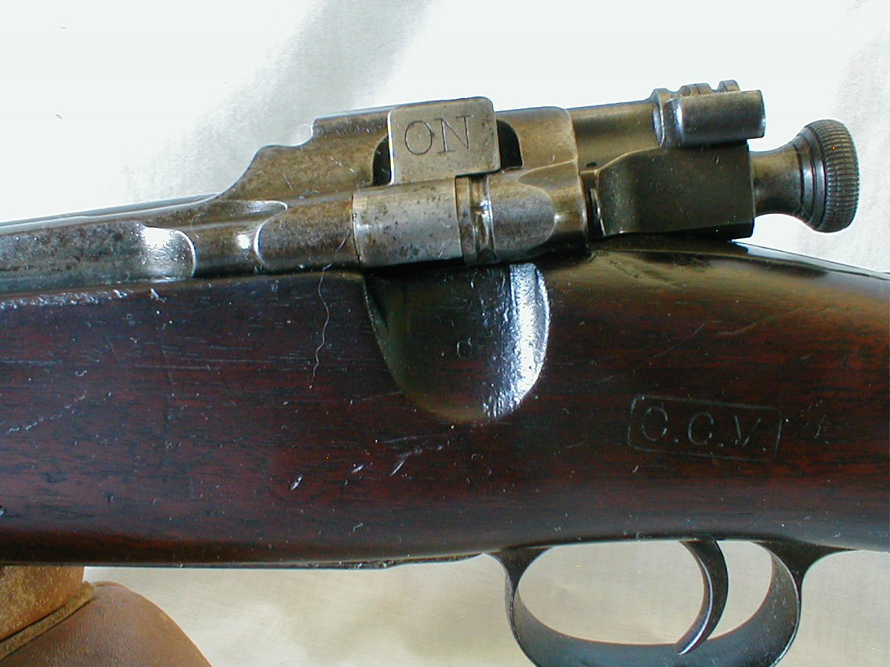

    photos of C.C.V. cartouche
    here are some photos of a CCV cartouche on a early SA 1903 stock
