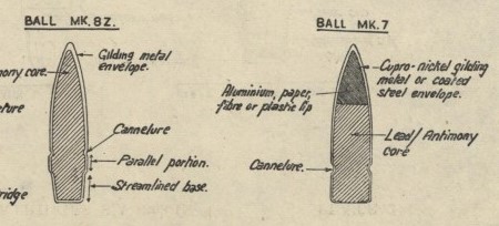

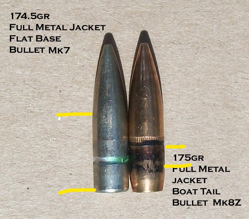

    This, combined with using BT bullets could be one of the problems .....................................

    The BT has relatively little contact with the rifling and does not upset easily compared to the open bottomed MKVII round.
