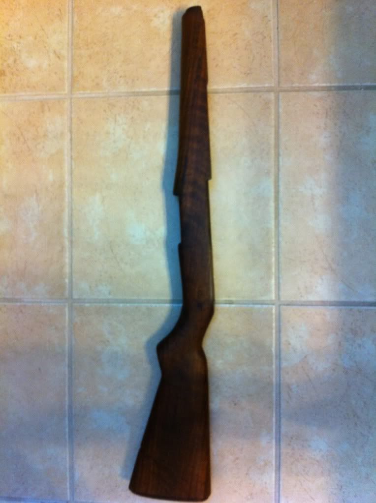

    Quote Originally Posted by JBS View Post
    Attachment 28928Very gentle buff with cleaned 0000 steel wool. This will produce a sheen instead of a gloss. Here is one of my restorations
    What he said. Or, you might apply a coat or two of Culvericon's Paste or Tom's 1/3.

    CMPicon has great information about wood restoration, here is the link,
    Armorer's Corner - Wood Cleaning Article
    I have a couple of CMP M1icon's and have re-oil the stocks. They were originally oil and the red color comes from oxidation of the oil with time. The were dull when they let the factory. I use a mixture of pure Tung oil with mineral spirit, here is finish product of my 55 after 4 coats,
    http://i1186.photobucket.com/albums/...srq/photo4.jpg
    http://i1186.photobucket.com/albums/...srq/photo3.jpg
    http://i1186.photobucket.com/albums/...srq/photo2.jpg
    http://i1186.photobucket.com/albums/...srq/photo1.jpg
    http://i1186.photobucket.com/albums/...srq/photo5.jpg
    Good luck

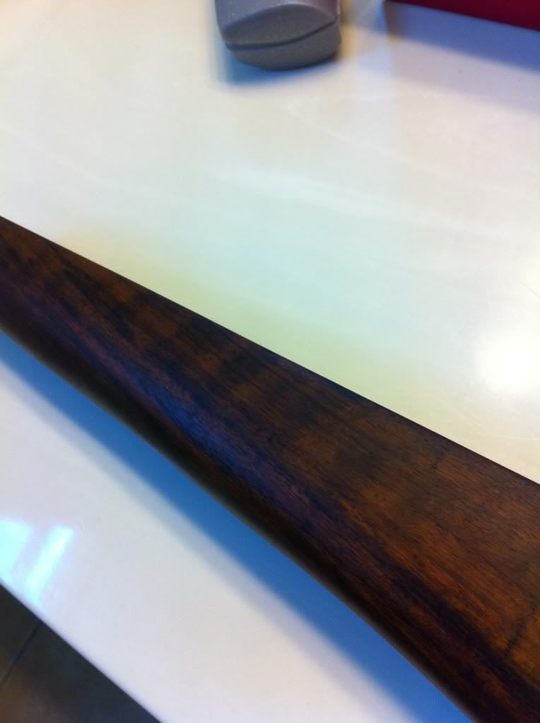

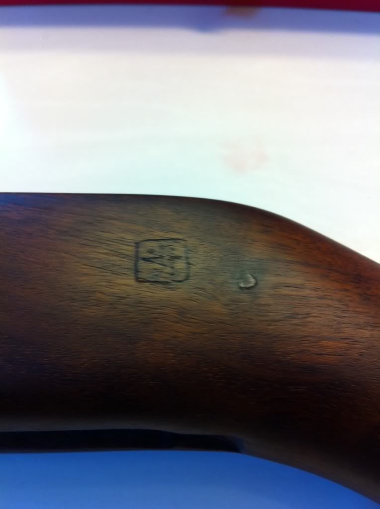

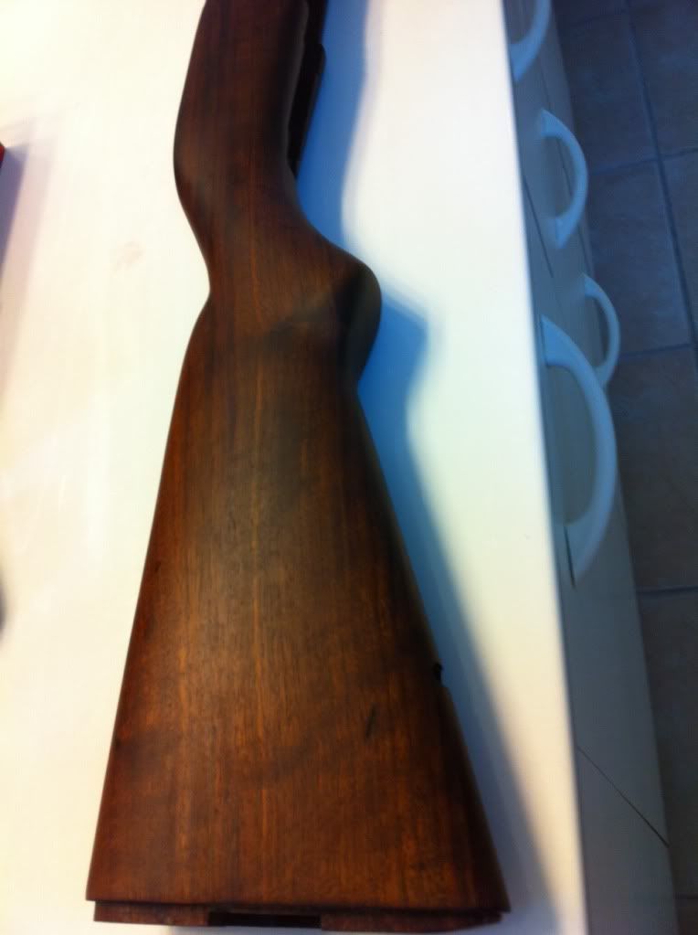

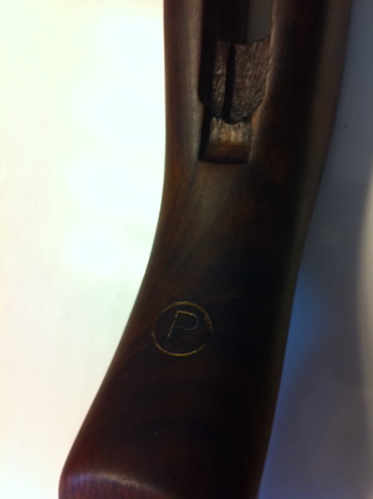

    Just wanted to follow up to my BLOicon question with the results, special thanks to Harlan for all his great assistance!
