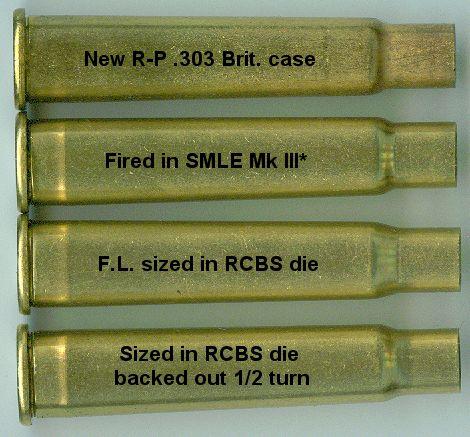

    +1 on the Lee collet dies. I have found in the past, and is shown in the picture, that FL sizing or allowing a FL die the touch the shoulder results in a shoulder of a different shape. On my cases the shoulder never matched the factory chamber shoulder. One reason I went to neck sizing only, so the shoulder didnt get work hardened.
