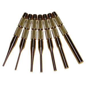

    Use a brass drift punch and hammer.
    Here's a set of brass drift punches.
    $19.95 with free shipping... not too bad a deal.
    Brass Drift: Punches | eBay

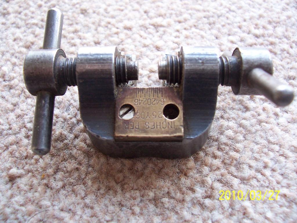

    Or you could always just use the correct tool
    Few and far between.
