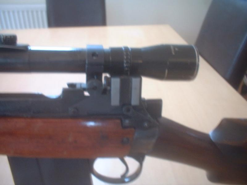

    Any quesses on what an original Enforcer safety is worth. Also any update on EFD's reproduction safety?

    Why is an Enforcer safety any different than a normal No4 safety? Am I missing something....., on the basis that an Enforcer is a commercial and not Milspec rifle.

    The Enforcer has a shorter safety lever that allows it to clear the PH5E sight base.

    My Enforcer Clone (top Picture) with the standard No4 Safety - it wasnt till I actually got out to try it that I realised the safety wouldnt move.
    Bottom picture - with the correct 'short' safety which EFD found for me in his 'bits & pieces'
