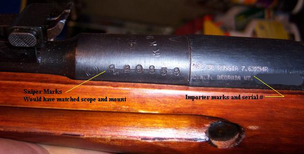

    You can, of course, find a rifle that was once a sniper then converted back to an Infantry rifle. I run across them all the time, and converted a couple back to sniper config...receivers will already be drilled for the mounts.
    Tula ex snipers will be marked 'CH'above the star, Izhevsk ex snipers will have a six digit number stamped into the left side of the barrel.

    Couple of examples.
ID:	122849   Click image for larger version
