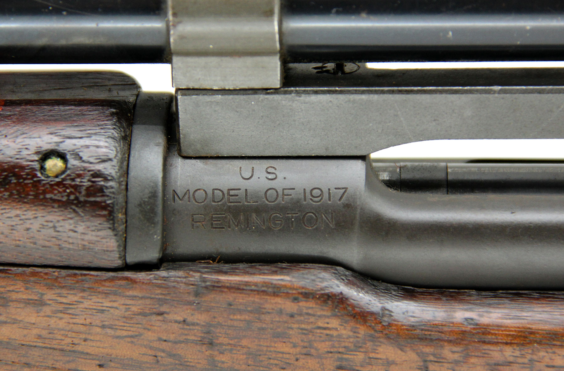

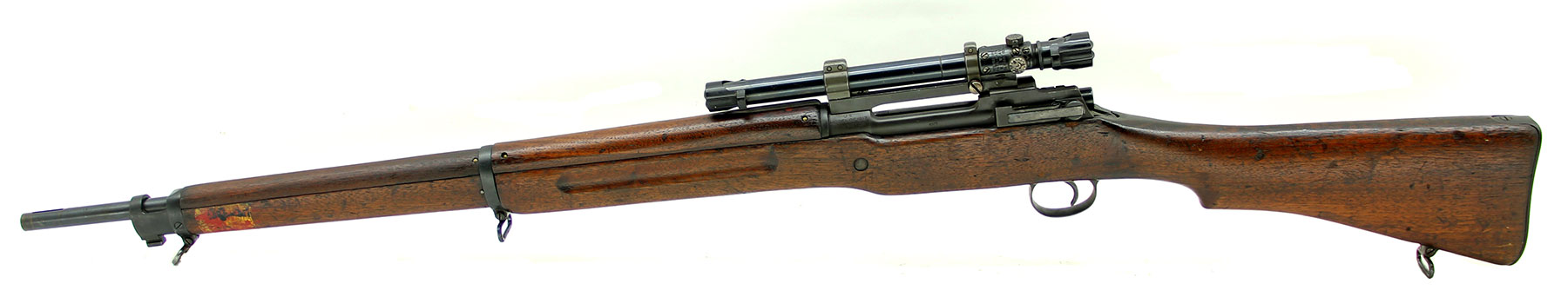

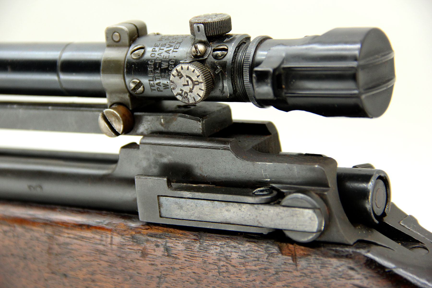

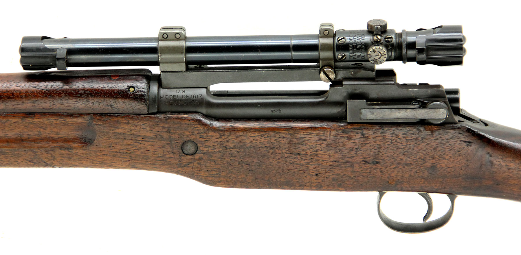

    The Austrian Army did a handful conversions on the M1917 rifle to M1917A4 configuration, with the M1903A4 mount and scope. Therefore they grounded the rear sight base and even bothered to do a new receiver inscription, in the same fashion as the M1903A4 rifle. Attached are a few pictures.

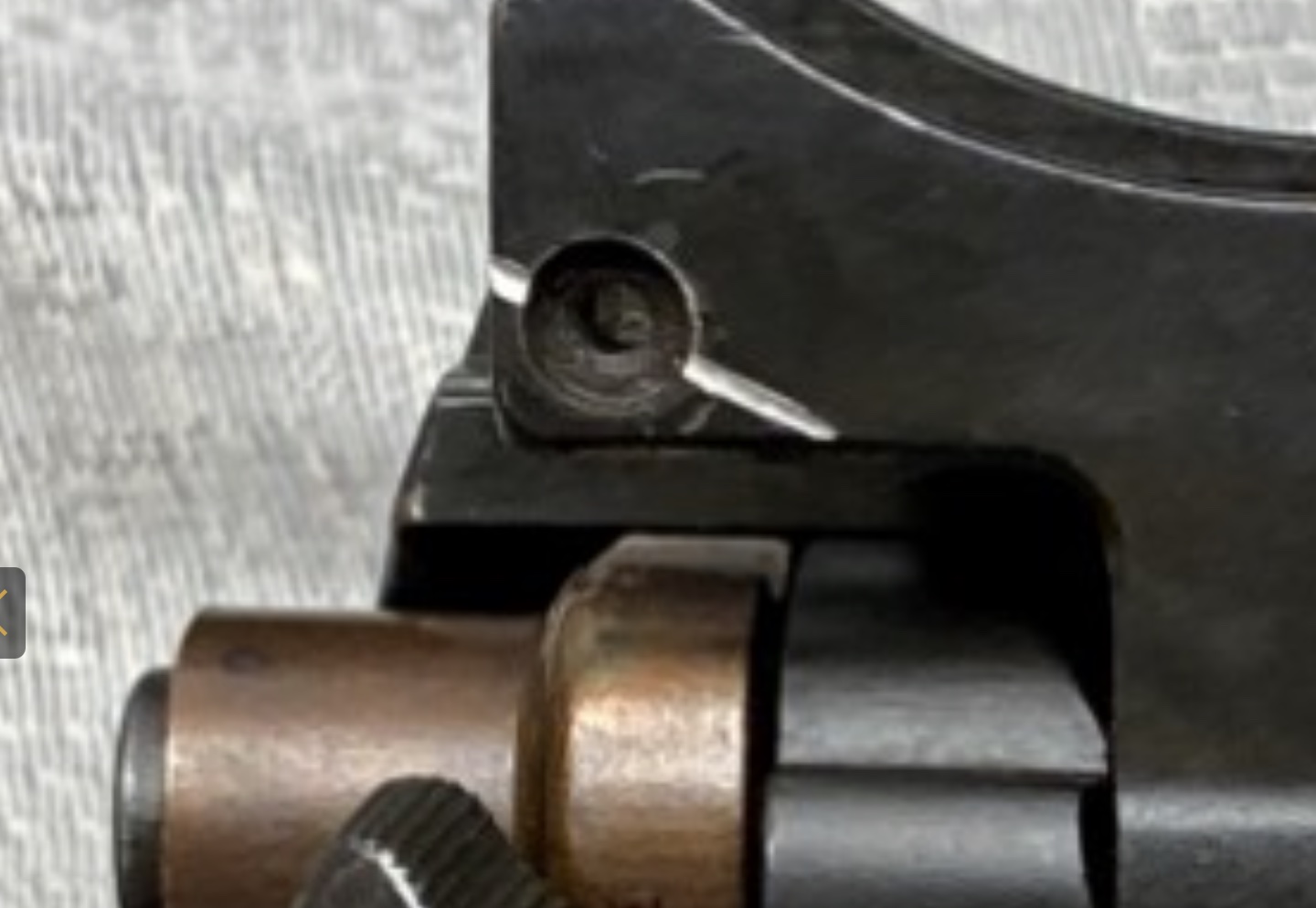

    Very interesting. I've been wanting to find a 1917 sporter to restore, but haven't found a good candidate - to many have seen the ears ground down. I'll have to look closer now and, if the flat of the rear sight base is still intact, I may have to build one of these.

    Give us a look when you do?
    A quick search found a several 1917 sporters on gunbroker with the ears cut down, a few of them for ~$200-300. Most have the rear area rounded, but some appear to have a little "flat" left.
    I saw one interesting candidate sporter with the ears still on, but no rear sight. Seller said it had been fit for a scope mount - which to me meant one of the S&K type mounts. I believe I some of these mounts required drilling out the holes in the ears to fit the larger screw that was needed. If that is the case, then I wouldn't have to feel bad about grinding the ears down and making one...here it is
    looks like bubba cut the screw out.
    Other Jim's reference picture in this post has me thinking about just making one with a long target scope.
    I will keep looking for now. Price needs to be preferably <$200 to warrant $400 for a new set of wood, and possible $200 for a new barrel. Sorry to hijack the thread with my wishful thinking.
    Ye gods! If they'd put a Zeilvier in turret mounts on there they would have really had something. Some effort went into those lens covers; though that miserable scope hardly deserved them!
