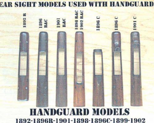

    The various Krag rear-sight models require specific handguard hole-openings and mounting screws.
    If your Krag has a handguard, a photo of the rear-sight opening would allow identification of the sight model that you need.
    By the early 1900's, only the model 1901 and model 1902 Krag sights were being used, when rifles were being arsenal 'refurbished'.

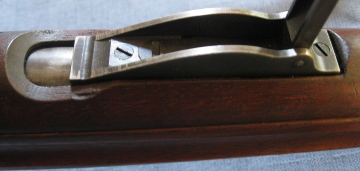

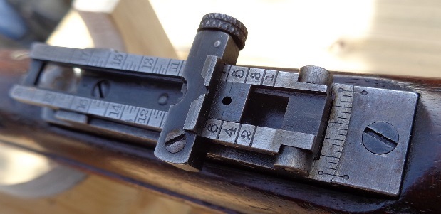

    Attached:
    Examples of a 1901 and 1902 Krag rear sight, with correct handguard for the sight model. Also, a handguard guide done by Tom Pearce for the Krag Collectors Association Forum.

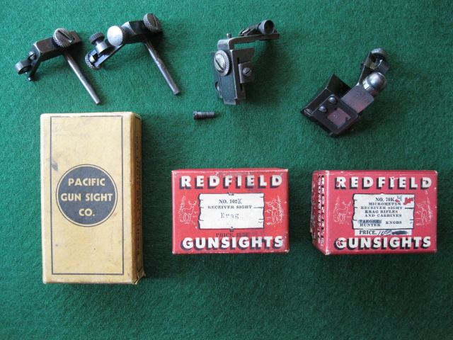

    (Possibly your 'sporter' Krag once had a Pacific, Redfield, or Leroy Rice "No-Drill" peep sight on it, that resulted in the removal of the barrel sight)?
    Does your Krag have a magazine cut-off lever in place on the left-side of the receiver?
    If the cut-off lever has been removed, it is possible a Pacific or Redield 'no-drill' receiver sight was once used on a 'cut-down' Krag.

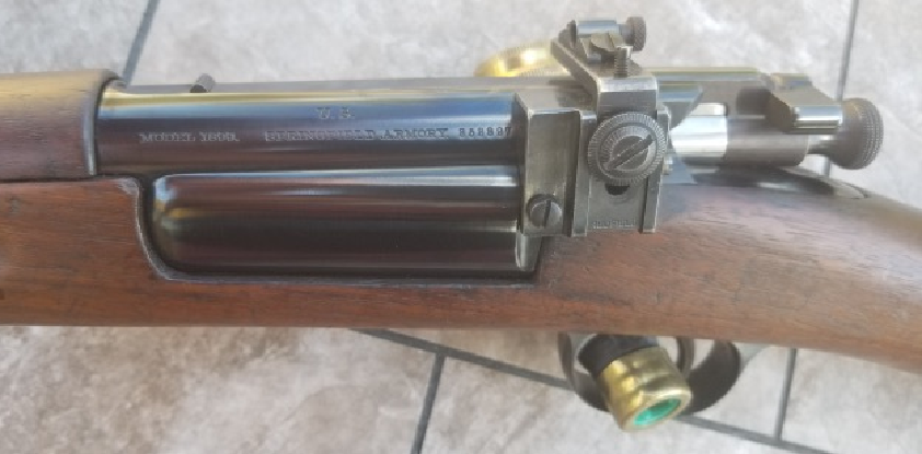

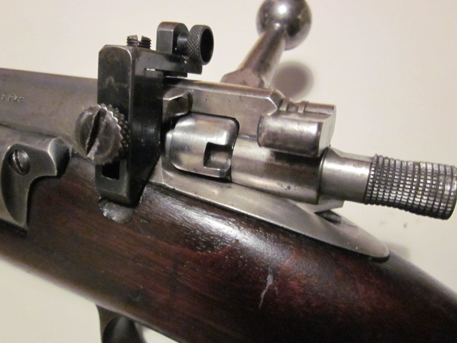

    Well it smells to me that it was set-up to wear one of these!
    The Redfield and Pacific 'no-drill' receiver sights for the Kragicon made use of the 'magazine cut-off hole' for mounting.
    (btw - dovetailing the barrel is, in my humble opinion, a poor solution. Other sight solutions may materialize).

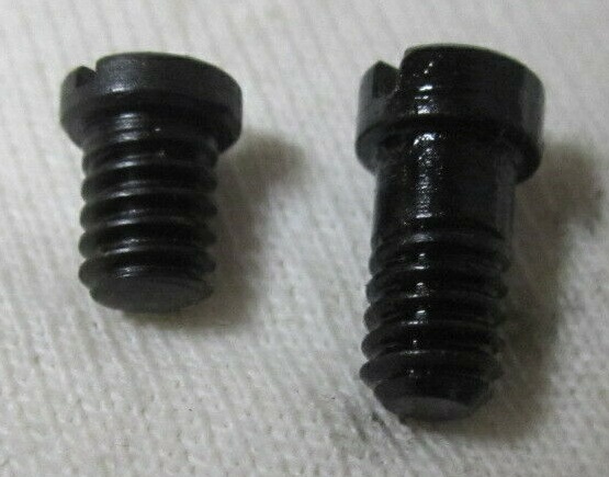

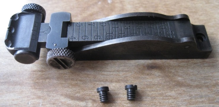

    It may also be worth noting that, although the hole spacing and threads are the same on all sight models, the screw length and head shape are not.

    FWIW - The model 1892 Kragicon rear-sight uses the same screw combination as the model 1896 sight.
    The rear screw is short with a very thin head. The front screw is long with a thick head.
