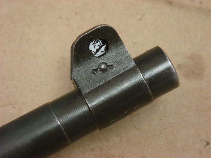

    Questions: is there any marking on the frt on your frt sight?

    You always make me laugh She did the sensible thing and paid off one of HER credit cards( she knows that as soon as I croak, she gets to sell my guns anyway). So, the IS oiler isn't correct? I was guessing Inland made on the mag too. Looking down the barrel, theres a "T" on the left side of the front sight. I tried to get a pic, but my phone and this light come up empty. IDK what a 9 spring cut is. Back wall has a groove on each side. The MR is gone. There's a mark, but it doesn't look close to an M or R.

    Your Frt sight is probably a TR, Look for a marking on your L flip leaf. Common staking by RMC......... Well, just look at these pics.
    I looked closer at the frt sight there's an R on the right side too, but not the same lettering style as the pic you showed.
    Just an "S" on the rear flip , there's no B-R at the peephole.
    The ears on the frt sight have the line on each side of the "pin" hole, just like the pic you showed.
