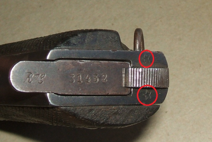

    Are there stars at the base of the grip?

    here are the marks on mine , are these the acceptance marks?
