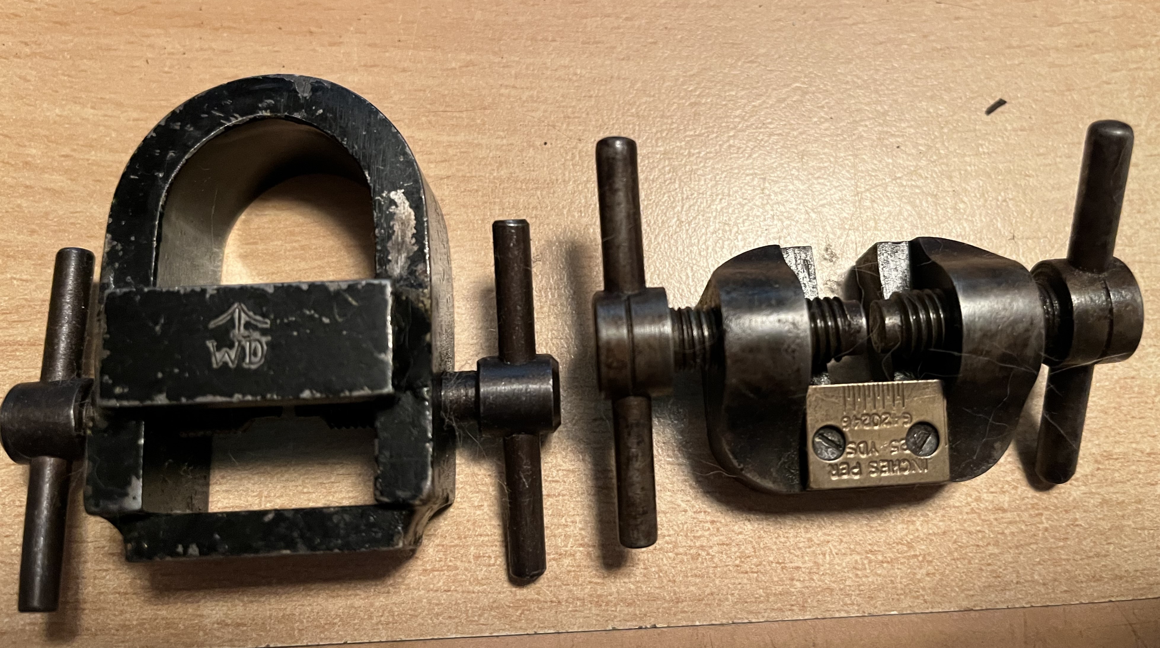

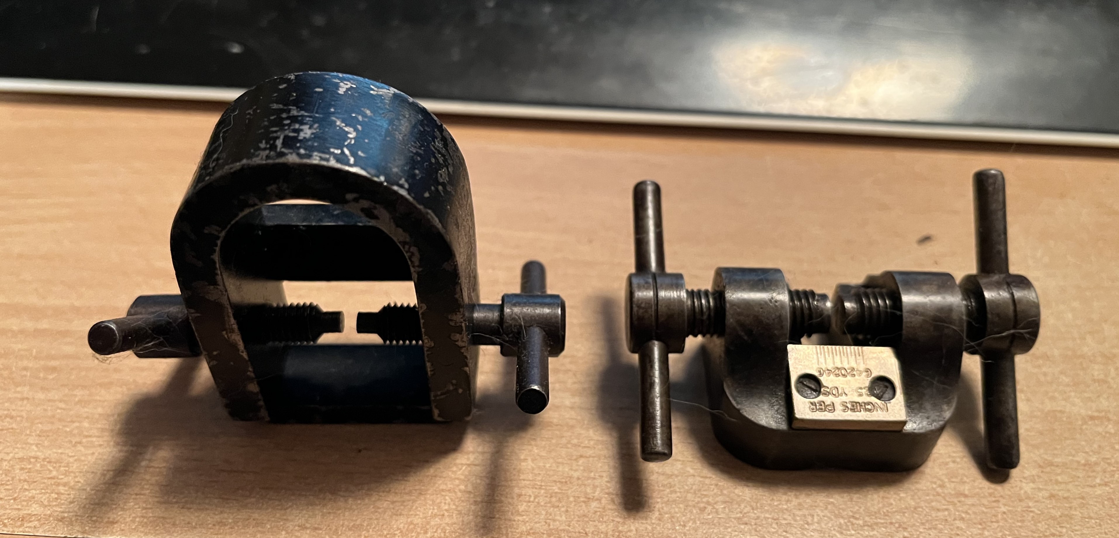

    Sight Adjustment tools.
    For the 303's as far as I know what I have;
    L - R ~ No.4 rifle sight adjustment tool, No.1 MkIII sight adjustment tool.
    Yeah they're a bit dusty dont really touch them much as you can see think there is some Siamese stuff there as well bl**-dy cat!
    He thought they were for him...

    Yes he is a bit of a bane in my room most times jumps up whilst I'm typing something causing keyboard chaos, of course it's not his fault by the look I get !
