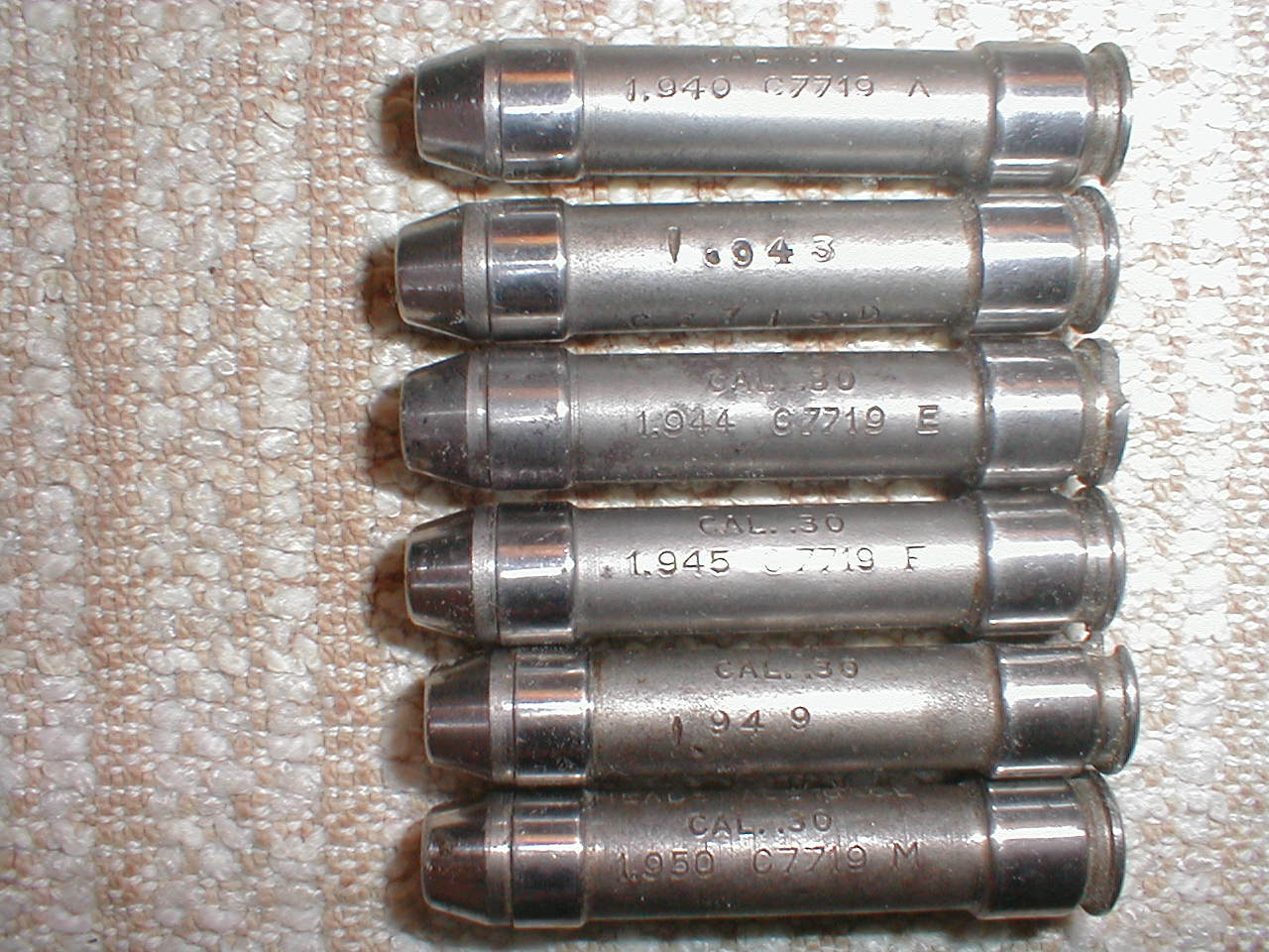

    headspace gages
    It is a smart move to order new headspace gages for 30-06
    I have a collection of US military WW2 gages for 30 cal (M1icon and M2) but would not trust them as they have been used quite a lot over the years. they start with 1.940 and end at 1.950.
    Arsenal gages were sent to Springfield or RIA to be checked and sometimes re-calibrated once a year and will have a gage card with each gage.
