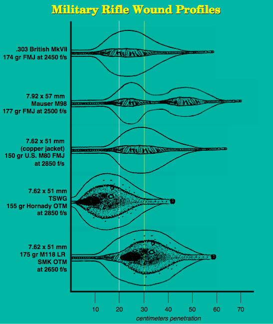

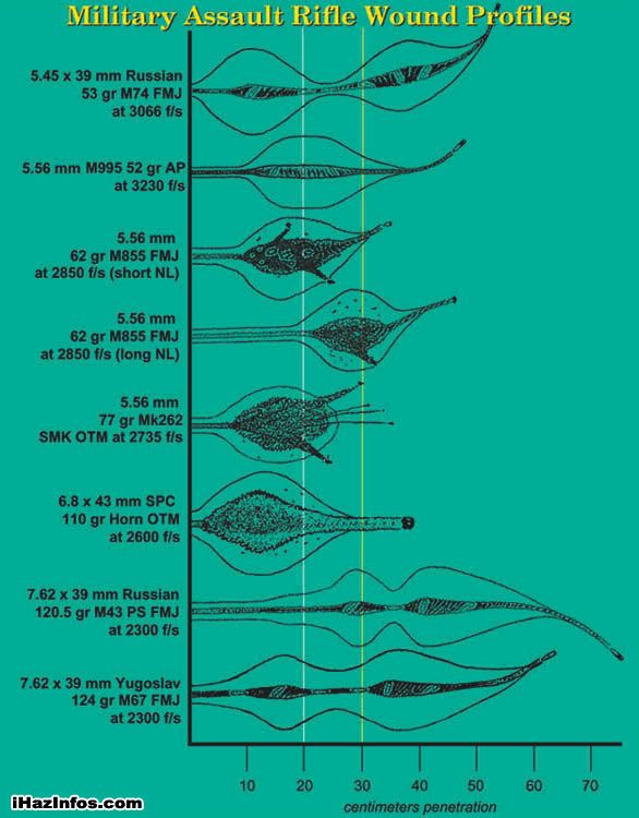

    Various wound profiles :
Name:	Penetration By Calibre.jpg‎
ID:	138544   Click image for larger version
Name:	Penetration By Calibre (2).jpg‎
ID:	138545   Click image for larger version
Name:	Penetration By Calibre (3).jpg‎
