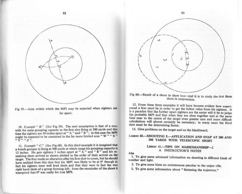

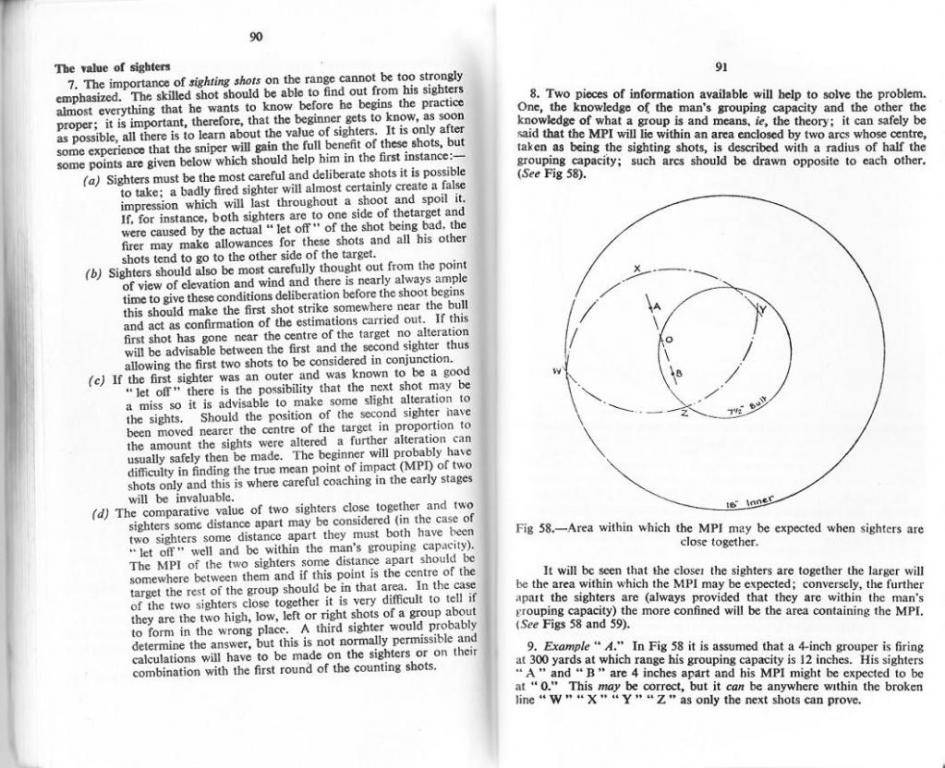

    Arrrr..... The million dollar question was it me the ammo or the rifle?
    I may not be able to help with that from here, but here is a useful exert from the Britishicon army that we all should be using to check our MPI (group sizes). I hope it will help in some way.
    Chris
