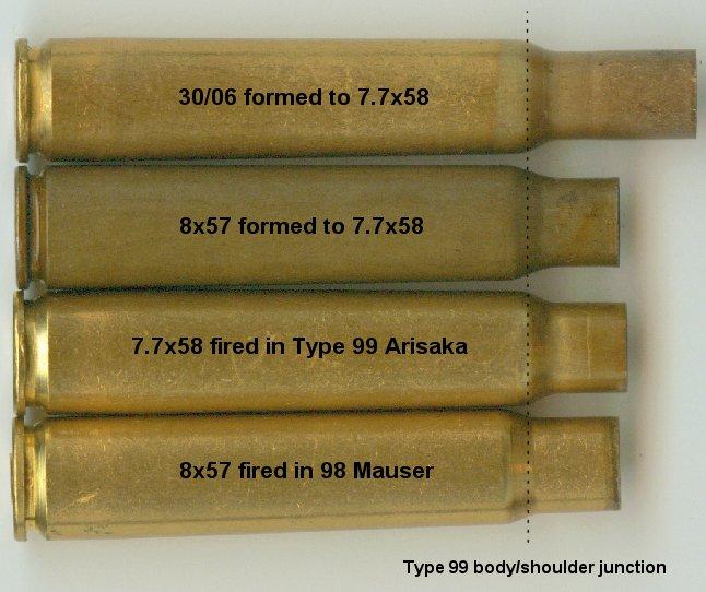

    It's very easy. Lube sparingly (castor oil is good), run the '06 case into a 7.7 Arisakaicon FL sizer, trim to length, deburr.
    Using 8x57 cases can be problematical, since they're a little short in both total and head/shoulder dimensions. Normally, the tiny secondary shoulder left then the 8mm neck is reduced provides adequate headspace support for fire forming - but it's advisable to check end-play before firing normal loads.
