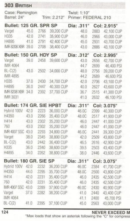

    Below is good reloading information for your .303, it keeps the pressure at or below 43,000 CUP or 46,000 PSI (traducer method) and I highly recommend the load data.
    Please note that the load data below shows 48 grains of H-4350 as a max compressed load at 43,800 CUP and well below the 46,000 max pressure listed for the Enfield Rifleicon.

    Quote Originally Posted by r22r View Post
    Thanks you very very much for taking the time to respond to me. You gave some very valuable infos and I'll be sure to use them ! So there's no problem using .312 bullets in a lee enfield instead of the .311 ?
    thansk again
    JP
    READ the Hodgdon's reloading data I posted above, the 150 grain Hornady bullet is .312 diameter that means it is OK to shoot in an Enfield Rifleicon.

    r22r
    The best advice I can give you is buy more than one reloading manual (the more the better) and start reading from the very front of the book.
    You want to absorb as many facts from the beginning of the book as possible and keep reading as long as you reload.
    What I really want to sink in is the load data I posted from Hodgdon's is 3,000 psi below the rated chamber pressure for the Enfield Rifleicon. It is also very close to what the pressures are for factory loaded ammunition. The older Enfield's are rated at a lower chamber pressure and the factory ammunition MUST be safe to fire in ALL Enfield's
    Your loading data from the Lee Loader is actually lower than the suggested starting loads listed from the Hodgdon's data I posted. This is to make sure you are safe and the chamber pressures are MORE than safe.
