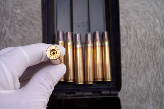

    Here is a picture of the brass:
    The brass is described as follows:
    "30-06 LC-62 Match brass, unfired, deprimed. RARE! This is original Lake City US military spec. match brass in excellent condition." and is somewhat cheaper than new commercial brass.

    Quote Originally Posted by Calfed View Post
    LC '62 M72 Match brass is not rare; it is simply puffery by the seller. I have thousands of this brass (It is a good year, by the way).

    Quote Originally Posted by USSR View Post
    Don
    Thanks Don. Glad to hear about the LC-62 being a good year.
    Unfired LC 62 match brass is fairly rare around here. I'll take the seller's words for what they are worth. Guess a certain amount of puffery is to be expected.
    The seller is looking for .35/round for the Match and .25/round for the LC-69 unfired "non-match" brass. Primer crimp will have to be dealt with on that.
    Guess my question is whether I would be better off with the match, non-match or commercial, which seems to run around .40/round in these parts
