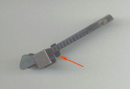

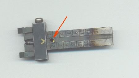

    If you can get a spare rear sight leaf, install a No. 8 or No. 10 socket head set screw. This is a K31icon sight, but I have also done it with Mausers:
    The yellow mark is a filed "nick" with paint to use as a reference for repeatability.
    The length is "tuned" so that the screw is just out of view when the sight is at minimum elevation:
    On this one, there is sufficient range of elevation for 1000 yards, and I can make reliable adjustments of 1 MOA or less.

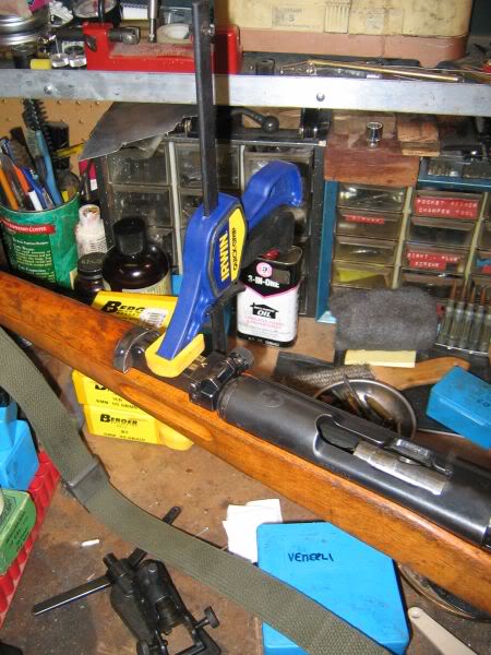

    To remove/replace the original sight blade, I use one of these bar clamps with soft jaws to compress the rear sight spring while I drive the pin in or out:

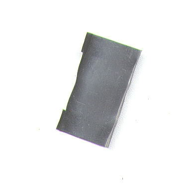

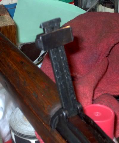

    If you are not willing to alter even a spare sight, you can cut shims that will fit underneath the rear sight slider. Brownell's sells shim stock in various thicknesses. The most useful sizes for this purpose are .003", .005" and .010", which are easily cut with sharp scissors. This one is cut to fit a K98kicon sight:
    Shim on the K98k sight. Hard to see because of poor lighting, but it is there!
