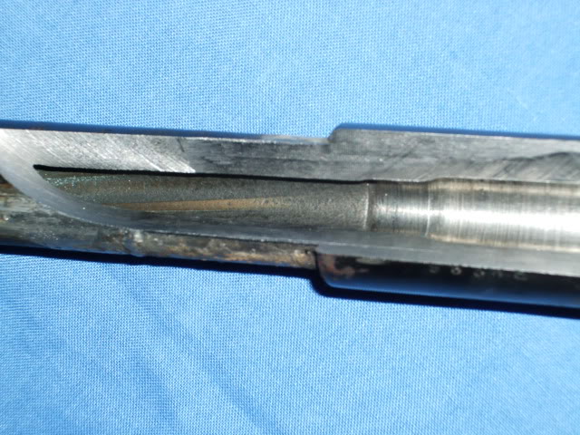

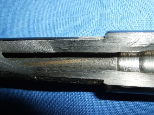

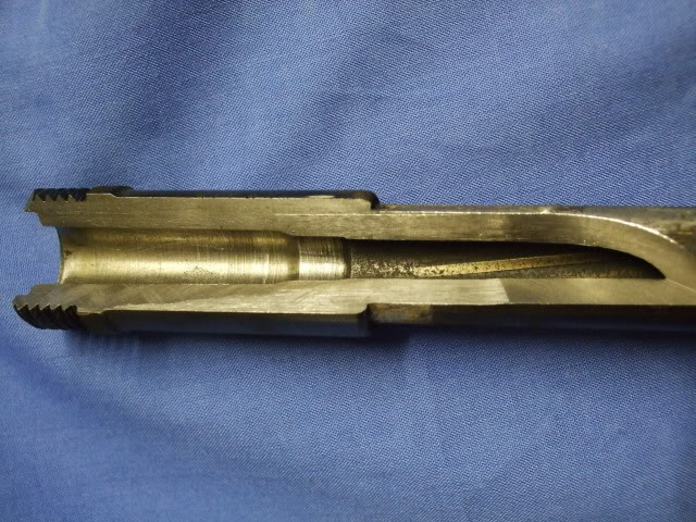

    A bad case of corrosion, tried with a 1/4 " cutter as Peter suggested but didnt allow enough light for a pic so opened it up. will get the rest of this done and others at some point and post.

    Brilliant................. One pic really dos describe a thousand words! What would be very interesting to see now would be a Mk2 barrel where the reinforce is shrunk on to the barrel and pinned. Got one of those handy BigDuke?
    This opens up a very interesting question now........... (sorry about this.....) What would be the legal status of a 'barrel' cut/machined like this. If I had to give an expert opinion I'd have to say that it's nothing but asctioned length of barrel not capable of ever doing or being anything else, ever, in the future.
    Great work Big Boy.....

    Think its a catch 22, regarding the status, if the chamber was cut in a way were it cannot support a round and a lot more of the barrel is sectioned (both sides etc) and the thread removed then cannot see it being a problem.
    Again if it was just the rifled part and no chamber (barrel blank) then no licence required.
    The other reason for the way i cut the chamber is i have the old brass for this barrel and can use these along with new brass to show the variation.
    Can you shed some light on the Mk2 Barrel I gather we are talking about the Bren ?
