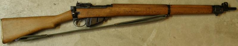

    Thanks for the pic's Krinko! A '58 Mk 1/2....damn another one I have to find. And I thought a '57 was going to be tough! I have run across '57 FTR'd Mk 2's but have yet to see a '57 Mk 1/2! I almost picked up a '49 1/3 but the bore was bad, in reflection I should of grabbed it anyways. Ah, the joy of collecting.
    Max, from my observations most of the makers of the No.4's have that step in the receiver side wall, except for LongBranch. On the earlier conversions in the previous pic's you can see them. Why they are there, I have no clue.

    Lance, this will really drive you crazy
    How about a No. 4 Mk. 1/3 Trials rifle? According to Skennertonicon, about 200 were made.

    How do you make a Mk1/3 trials rifle Jona? According to legend, trials rifles were all 1930's era Mk1's weren't they? Or am I missing something?
    In any case, even from the small amount of detail shown in the picture from the official drawings that we have here, that the 84L-- rifle shown in the photo isn't a BSA or a Fazakerley conversion

    It is a No.4 Mk 1* converted to Mk 1/3 configuration. It was a trials conversionN of a Mk 1* to see if such was practical. Apparently markings had not been decided on yet as the only indicator was the '48 FTR date.

    That wasn't converted to Mk1/3 spec at Fazakerley Jona. It might have been FTR'd at Fazakerley in 1948 but the 1/3 modification defiately wasn't there
