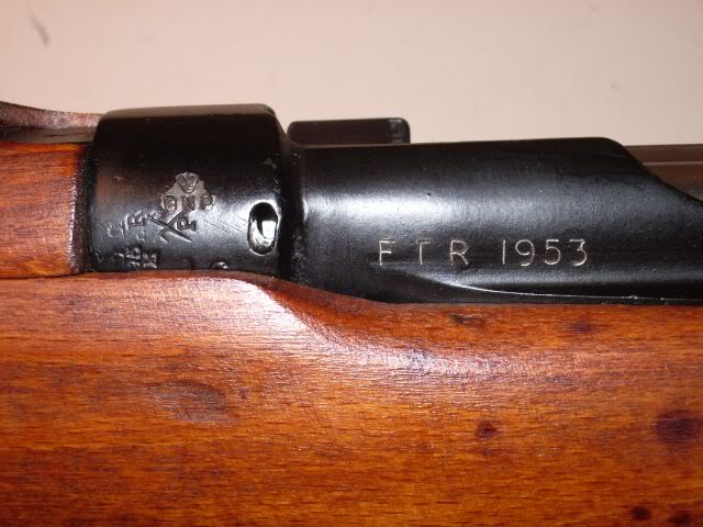

    The majority of bedding problems our Enfield Riflesicon have is because they were not re-oiled monthly with RAW linseed oil and the wood shrank as the wood dehydrated.
    The untouched Enfield below went through a FTR in 1953 and had raw linseed oil applied to it and NOT BLOicon.
    The dark spots (freckles) you see were caused by the impurities in the raw linseed oil, the "artsy" oil will not let this happen because it is so highly refined and filtered.
    The Clean Strip BLO will seal the wood and make it more water proof than RAW linseed oil, BUT it will need to have the shine knocked down with 0000 steel wool. Using BLO will make it far harder to apply successive coats of linseed oil that will sink deeply into the wood and keep it hydrated.

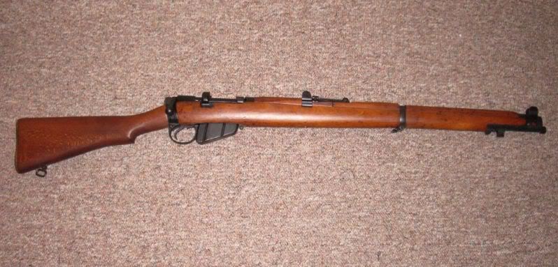

    My main point here Thunderbox is you should oil the stock with raw linseed oilicon BEFORE deciding the stock is a loose fit and before making bedding adjustments. As an example cork sheets under the barrel tip or bedding your Enfield with beer cans and credit cards when oiling the stock just might fix your problems.
    Below is a 1950 unissued Canadianicon Long Branch rifle I purchased from Brian Dickicon, it has a slight wood shrinkage problem. The first thing I'm going to do is give the stock a long drink of raw linseed oil before even thinking about shimming any part of the draws.
    Raw linseed oil will re-hydrate the dry wood in the stock and cause the wood to swell or enlarge.

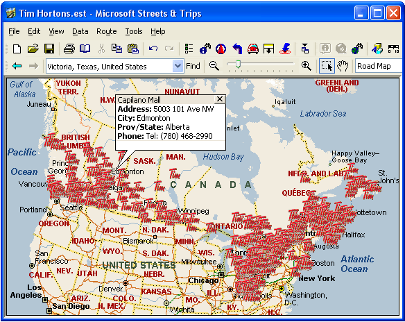

    Ed, great map and remember many many years ago we had a battle with our now "best friends" and burned you White House. Thankfully you did forgive us for this but I constantly hear you had a plan to invade Canadaicon during the 60' thur the 90's. Would that mean you would have invaded yourselves first?
    Actually enfield303t that is a rumor the Canadian Government started to cover your own covert Canadian plans for invading the United Statesicon. Please look at the map below, all areas marked with a red Tim are now considered Canadian territory. (half the north east U.S. has been taken over)
    We Americans are not fighting to regain this territory because the coffee and donuts are sooooo good.
    (your beer ain't half bad either)

    Ed you are the first to notice what we have been doing for the last few years. My inside information is that once we get you and all your American buddies "hooked" on Tim's we are going to give you the ultimatum to "surrender" or we will "cut off" all your coffee and donughts. Now that it is in the open we will have to change our plans drastically.
