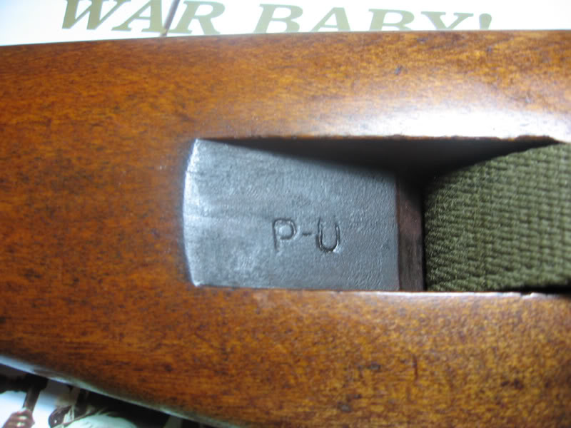

    First, I'll accept BrianQ's conclusion that the marking is a fake; while that doesn't necessarily mean the stock isn't an Underwood, it certainly makes it suspect. I'll post a picture of the sling well "P-U" marking later for any opinions.

    Here are pictures of the sling well marking and the handguard marking. Would appreciate knowing if these are legit.
    Thanks,

    My P-U stock from the CMPicon (still leaking grease months later) has two parallel rows of overlapping circular stampings (each one about 1/2" in diameter) marching down the slingwell ramp. Not sure what they are from but I've seen them on several other P-U stocks. Your handguard looks pretty much like mine.
