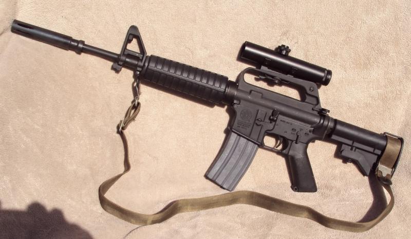

    Better pictures...
    Here are a couple better daylight pics of the XM177E2 wearing a Colt 4X scope clone with BDC for M193 ammo. The upper is the original, later medium-dark gray pakerized and the S&W lower is coated with Rustoleum dark gray automotive primer. The picture shows that it is a pretty darn close match.
