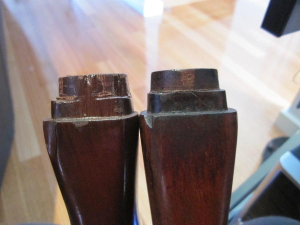

    I'll add a picture of the original and sporter butts together. From some angles the sporter butt had no taper and others, a large taper. I wonder if it was 'fitted' to the previous rifle.
    Peter, you mention cutting a dovetail in the wood, do you have a picture of such a repair that I can look at and understand the exact details? As much as the devcon/epoxy idea appeals, I would like to try doing it the 'correct' way first. I am hankering for a 303 sporter in the future and want to figure out how to correct any problems. I will buy something sporterised, not bubba-ize it !

    so, I fixed it tonight after putting a new to me butt on and finding out it moved too. This made me go and find the original butt which pulled up really tight. So I got the washer off the spare bolt and put that on ... voila, tighter than a fish's butt at 40 fathoms. It seems that the sporter butts get the hole drilled to a less exacting standard. No idea if it will make any difference to the accuracy but I can at least rule it out. I have also changed scope which may or may help. Suppose I should have waited to try it out before changing scopes but the screwdriver was handy.
