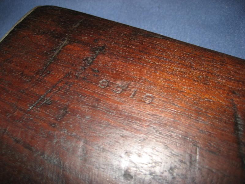

    For that price ($3825), I think its a good deal. If memory serves, its the only decent looking Johnson in original military configuration I've ever seen that has gone for less than four grand. The seller says its S/N is A9910. I know Canfield states that they weren't assembled in S/N order, but this one is close to one of the rifles used by the USMC according to Canfield's table. Wishful thinking on my perhaps though... Interesting enough, a photo she gave me shows the S/N stamped into the right side of the stock. Has anyone ever heard of this?

    Good find! I guess the seller wasn't looking to run up the price. Guessing a refinish on the metal, but if it's otherwise correct, it's no biggie. I don't recall having seen a S/N on the stock before.

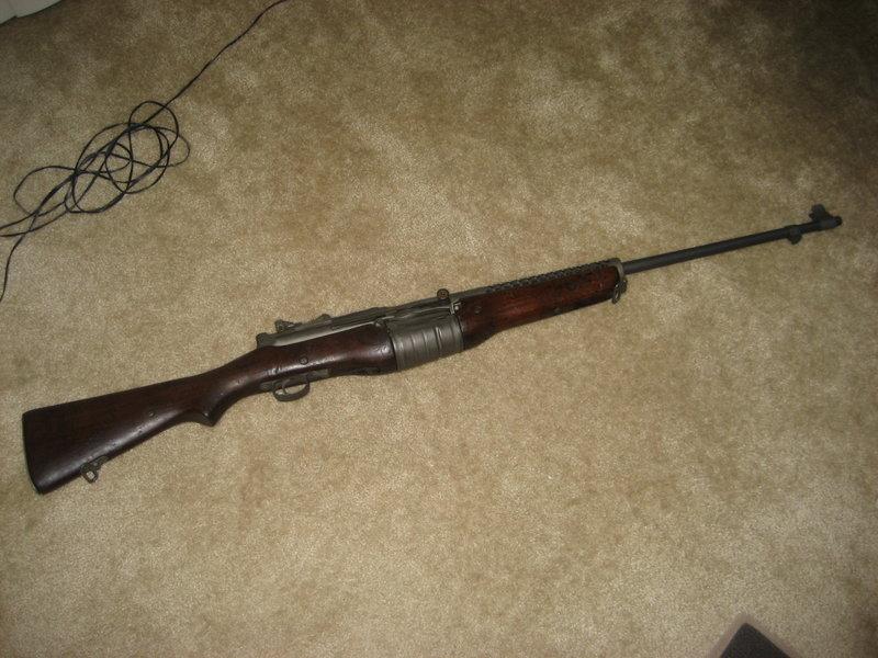

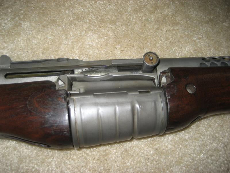

    Alright, it has arrived! Let me know what you think!

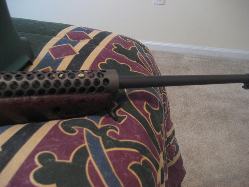

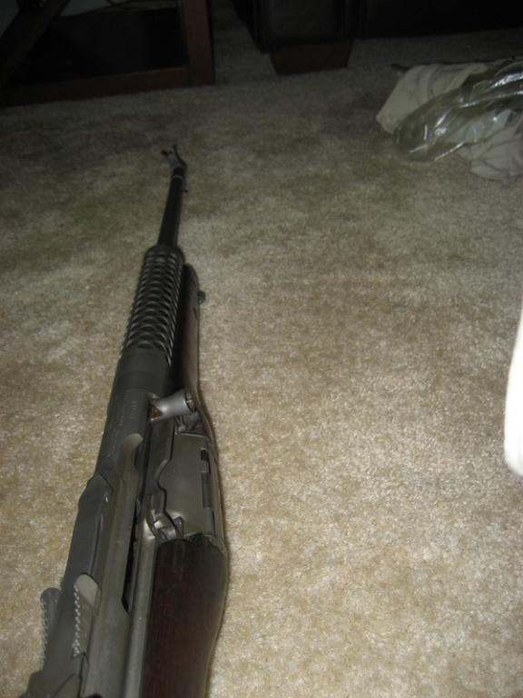

    The overall shot.
    Well, at least there is a little bit of life left at the muzzle. The rest of the bore leaves quite a bit to be desired, but the chamber appears rust free at least.

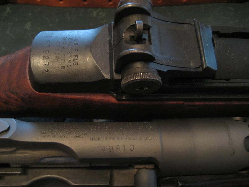

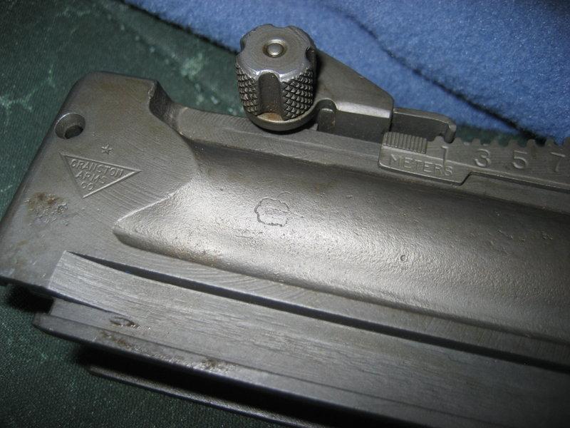

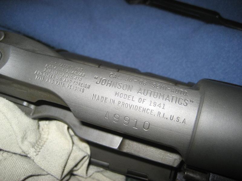

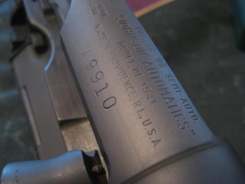

    The markings appear crisp and clean. I don't think this one has been refinished.
    According to Canfield, that star means it was accepted by the Dutch for service in the Pacific Dutch East Indies.

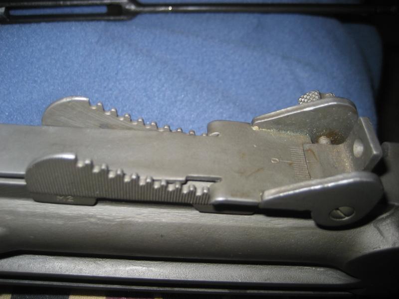

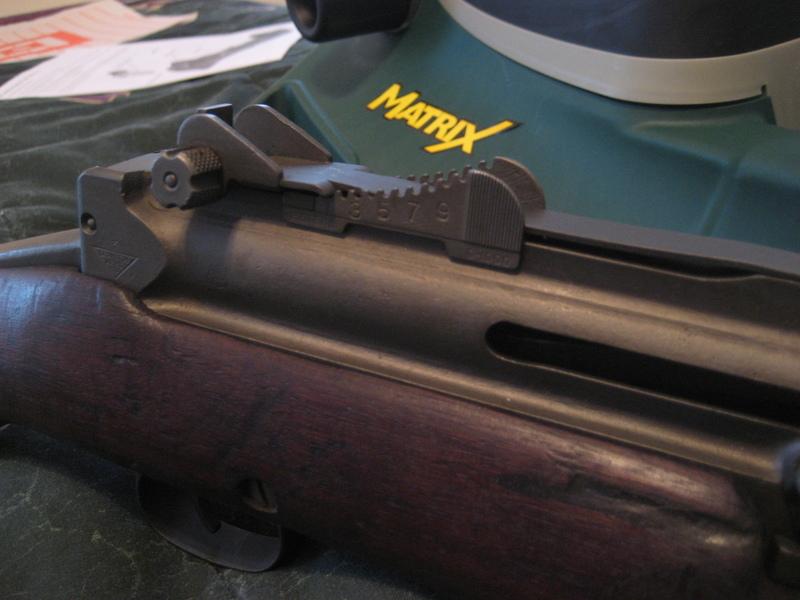

    The rear sight.

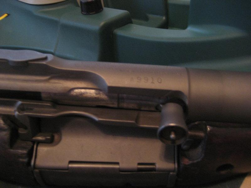

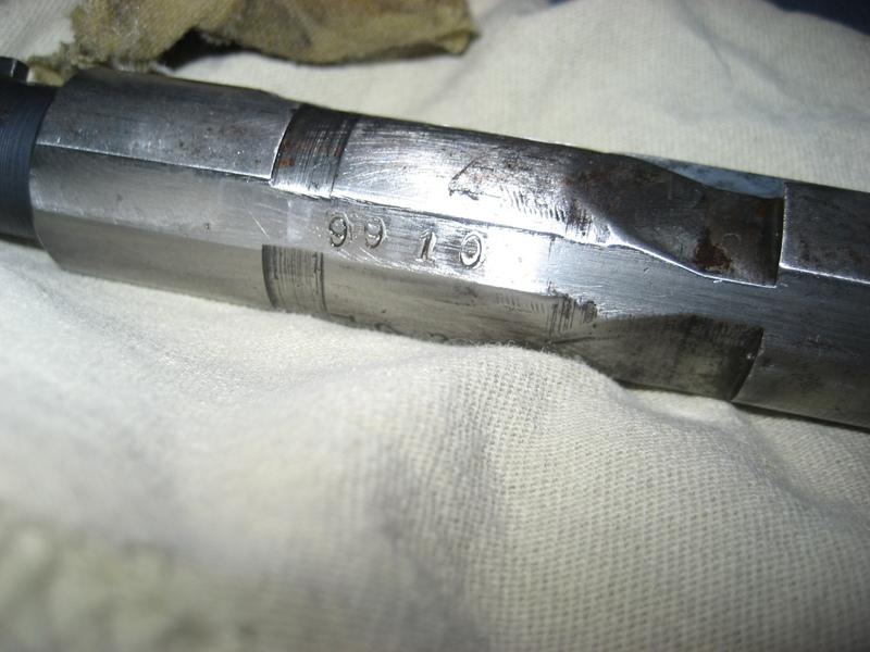

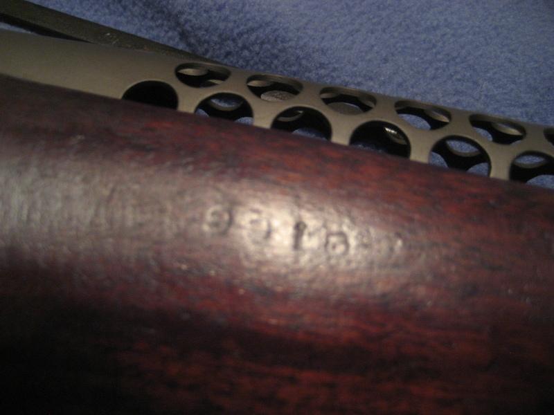

    The serial number was on both the front and rear stock assemblies.

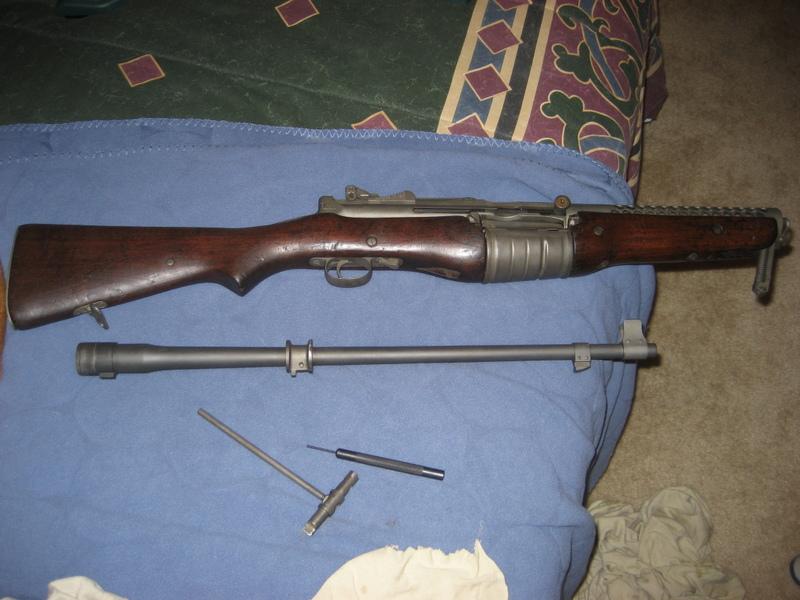

    The beginnings of disassembly.
    Disassembly was made easier by 'Johnson Cat.'

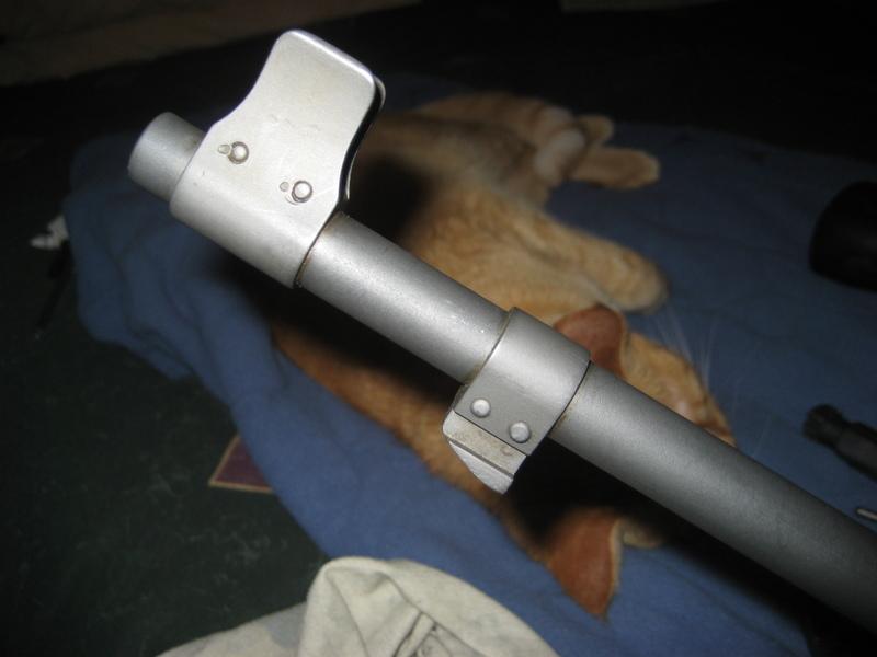

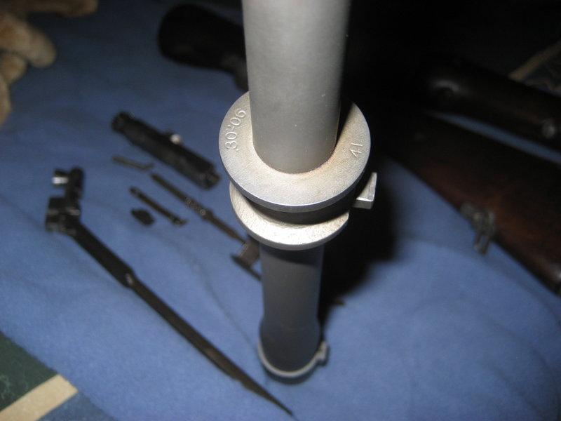

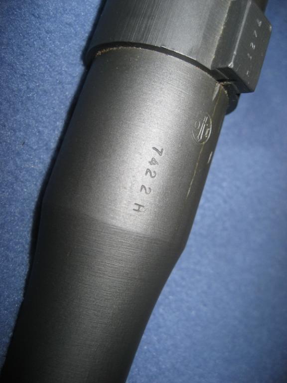

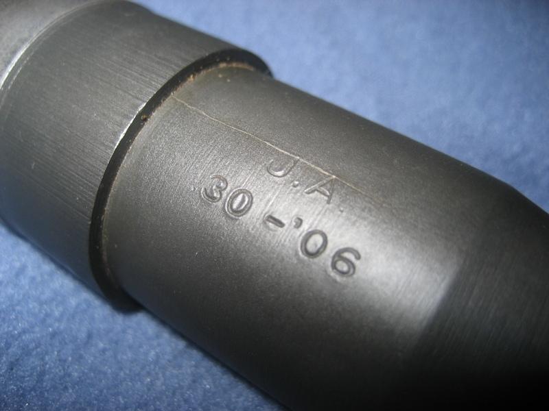

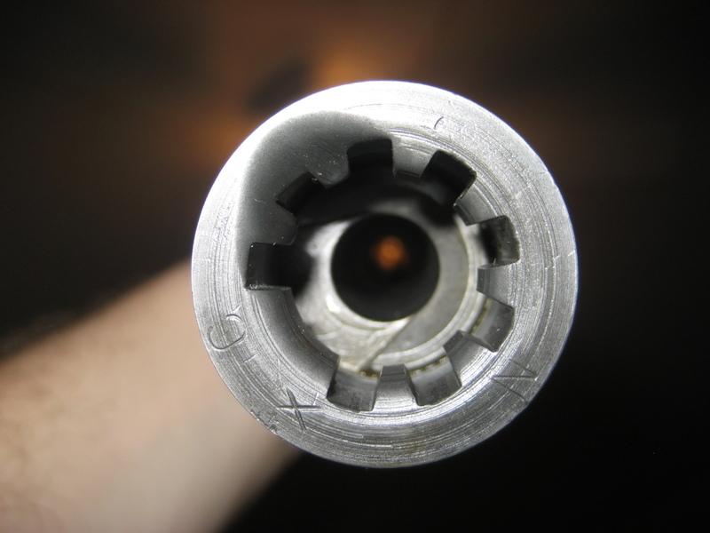

    Barrel markings.
    Given how crisp everything looks, I really doubt its been refinished, especially the barrel.

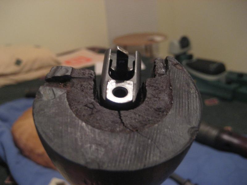

    The first chink in the armor. Will shooting it make this even worse?

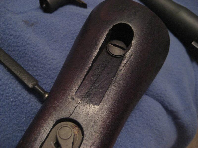

    The next chink in the armor. Are these cracks easy to repair?

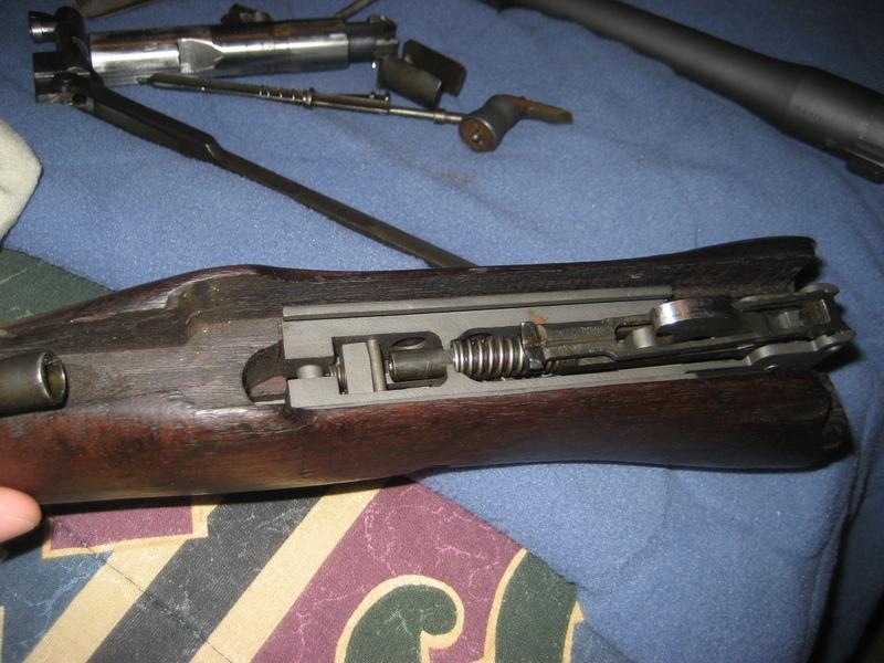

    The working parts in the stock.
    Has anyone ever heard of the bolts being numbered to the rifle?

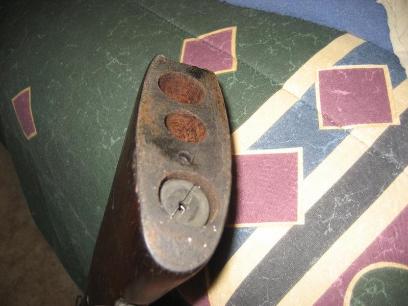

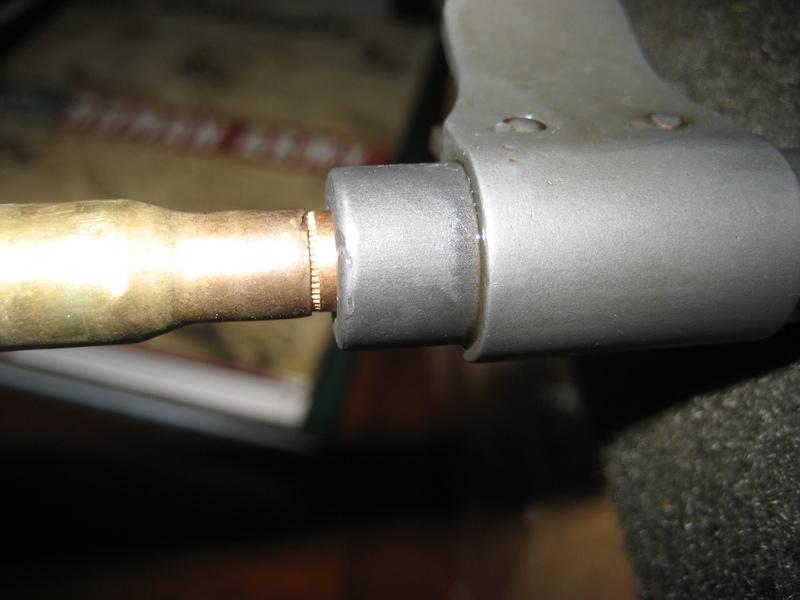

    At least I have some storage space in the butt, after I use the disassembled charging handle as a screw driver to take the buttplate off (a very clever tool inclusion in my opinion).

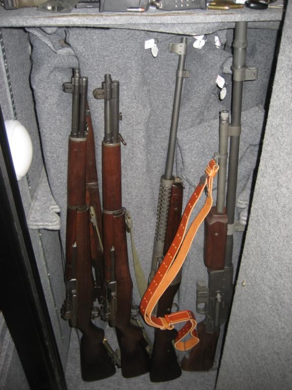

    The Johnson meeting some friends before the safe is closed for the night.

    Years back I had a near new B series M 1941 that had matching numbers on the receiver, bolt and iinternal parts. Many said it was a put together gun, as parts were plentiful in the 50's and 60's. Yours is one of the few that has a matching bolt that I have seen. Looks like a fine gun, but that buttstock crack may worsen if not addressed.

    From the photos, it appears to be totally reparked and I believe the bolt was renumbered to match. Just my opinion. The stock is too worn for the metal to be so new.
    Put grease or oil on the metal and it will eventually mellow out to a darker color and not look so new gray, Ray

    A phosphate refinish doesn't require taking the metal down to bare steel like most reblue jobs. a LIGHT bead blast is all that's required. I'm w/ rayg on this one! Besides, any experienced" Johnson won't be pretty. They were used pretty hard for a while and there weren't hardly enough to go around, I suspect.

    Gents, thanks for the responses. I will post some photos taken without the flash, but I still think the finish is original. The barrel and receiver are not uniform in color, the markings on the receiver are very crisp and even the tiny patent numbers are still well struck. I've posted the same photos over at johnsonautomatics.com and they're saying its normal for Johnsons to have more wear to the wood than to the metal. I'll try and get those photos posted by this time tomorrow.
