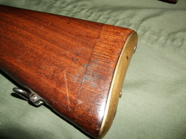

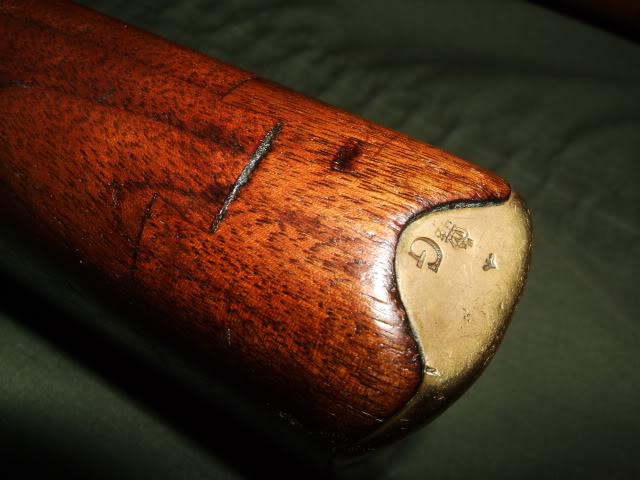

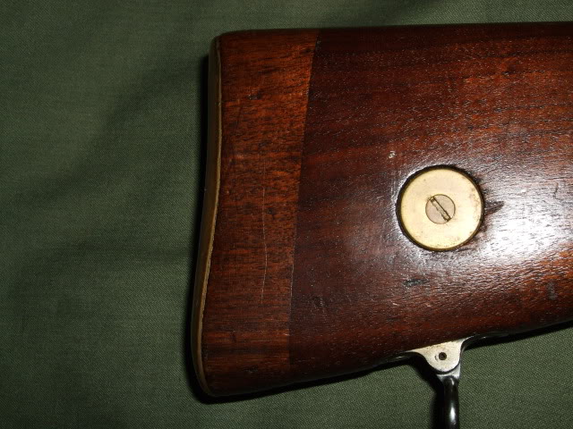

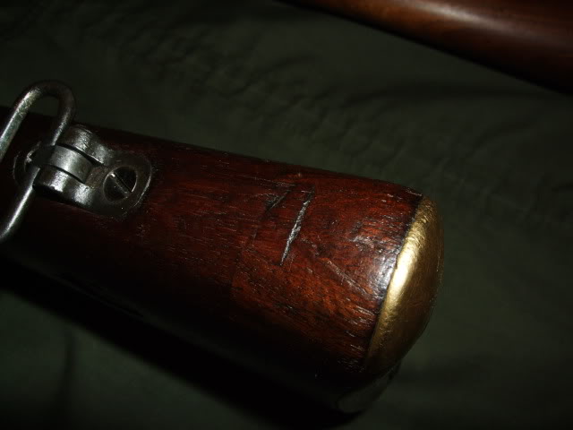

    Peter,
    Found a reference to extended buttstocks in the "Collectors Only" book SMLE (No.1) Rifles Mk1 and Mk lll, Volume 1, 3rd Edition , Revised. by Charles R. Straton (North Cape Publications, Inc).
    On page 74 of this publication Mr Straton observes that some buttstocks (specially on Britishicon made rifles in Australianicon service) had 1-½ to 2 inches of wood carefully dovetailed and fitted to the rear of the buttstock. He speculates that this might have been a "field" response to the need for longer buttstocks. He also notes that these modified buttstocks are the same length as the "Long" which were in short supply.
    The buttstock on my rifle is the same length as a "Normal" so I guess there was a scarcity of the "Normal" length too….
    I have attached some additional pictures of markings on my rifle and some more of the extended buttstock, with and without the buttplate.
    D.
    04-20-2025 @ 11:18 AM
    16,645
    05-04-2025
    02:11 PM
    Thanks for those pics Dad. The tung oil makes clear pictures difficult but the sheer quality of the work and the 'factory' shapes of the butt plate end lead me to say that these are a factory method of ectending butts. Without ANY doubt, there will be, somewhere, a relaxation in standards order that has authorised such a change in standards.
    If I had to think out aloud, I'd say that this was a relaxation, allowed at a factory (or factories) in order for them to make the best use of the existing resources available to them. This was quite common. I'd say that factory X or so had a lot of wood offcuts say, and in order to save waste or additional expense, would have submitted an example like this, had it approved after testing and given the go ahead. I would also suggest that if the order was for, say 900 medium butts and there were already 250 short butts there, surplus, then they'd modify thhese to save waste and resources. That's only my opinion based on nothing more than the quality of the work and the way the system works. We recently had some slightly undersize XX-XX xxxxx parts that were not exactly to the specification but after a short trial were deemed acceptable and approved for service
    I asked the old retired post war examiner about these in a phone call yesterday and he said that he has been asked to extend butts for individual shooting team members in the days of the No4 but when it came to push and shove, the rules always banned any modifications like that (I'm thinking Service SR(a) or SR(b) anyone for comments..........). So I don't think that they're ARMY/in service modifications. It definately wouldn' be a 'field' response because these are machine made fittings, finished on the factory, butt turning pantograph machines
    I have to say what a pleasure it is to see such quality woodwork. I took copies of the pictures to the Armourers shop and the ex apprentices all made glowing comments............. Wow............
