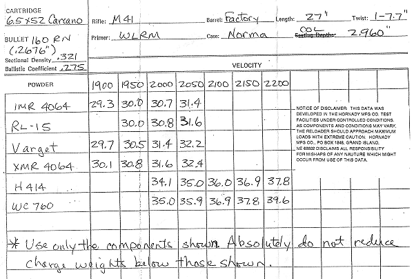

    No, but hte max loads he quoted are with magnum primers. FWIW, I load all my carcano rounds with regular WLR primers.
    In this case, the load data comes from Dave Emery at Hornady, and he insisted on the WLRM primer with the explanation that non-magnum primers gave inconsistent burns. I am a skeptic at heart, and if something doesn't make sense to me, I believe that I have enough experience reloading dozens of different cartridges to figure out my own loads. I broke with tradition on this one by virtue of the data coming from Dave Emery, a guy I am willing to trust, so I passed the loads along unaltered (except for rounding down to an even grain on the max loads).
    That having been said, like Claven, I use non-magnum primers in all my Carcano loads, including the ones from Hornady and have not encountered inconsistency. Of course it goes without saying that no-one on this or any other board will certify that their loads are safe in your guns, but I can say that the one with H414 and with the CCI BR and CCI 200 primer was safe in my gun (I'm a CCI primer guy).

    Do your homework on the primers
    I've read & have experienced flattening & primer blow out when NOT using magnum primers with their bullets
    Here is some data right from Hornady
