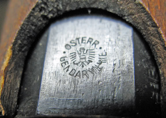

    Question AUSTRIAN ???? ENfield what is this
    Really unusual Enfield ay local pawn. Dated 1916. Stamped on barrel flat just forward of chamber is (sic) OSTREICH over GENDARMIE. I know this means Austrian Police but what is this doing on an Enfield?
    Wood has been sanded or whatever as no markings remain. metal finish about 50%. Priced ridiculously at $600.
    Alright 303 guys...what about this?

    Post WWII Austrian police were armed with allied weapons. No. 1 MkIIIs made in Englandicon, Australiaicon and India can be found with the Osterreich marking. There are also ex-Briitsh Smith and Wesson Victory model revolvers with the marking as well.

    Quote Originally Posted by tankerman View Post
    Not really. It means Austrian Gendarmerie which is not quite the same thing. A Gendarmerie could be thought of as para-military force. Many European countries have Police Forces and a Gendarmerie - Franceicon being the archetype. Not all Gendarmeries have the title Gendarmerie however e.g The Carabinieri in Italyicon and the Guardia Civil in Spain are both Gendarmeries.

    Same as in Englandicon. We have the real Police and the traffic police

    Thanks to all for the info. Sort of what I was surmising. While "interesting", for $600 I believe I will pass. Again, thanks to all for the time to reply.

    I don't know what they are really worth but I paid $200 a couple months ago. It was a good clean 1942 No. 1 Mk III* with the Österr. ...etc. The mark is so small I couldn't see it without magnification

    Mine was a tad north of $200 USD, a 1918 BSA IIRC. I need to find a nice revolver to go with it.
