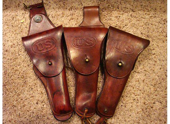

    Thanks guys for the 1912 info, Here is...
    a pic of a couple of of other holsters for comparison. The middle one is a Boyt 42 with a 1924 belt hanger and the end one is a nice Boyt 44. The 1912 did not come with the leg belt but did have two loops. Honestly the quality of the 1912 is comparable with the Boyts. Thanks Truman

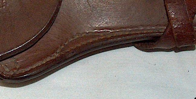

    As told, this holster is a good quality repro. "Repro" is a too good word when they reproduce also markings to fool people, maybe it's better call it "fake". Of course there are many details saying it's a repro, but the most obvious and detectable from long distance is the shape of the arched stitching in front of the trigger guards.
    In the pic an original R.I.A.1913
